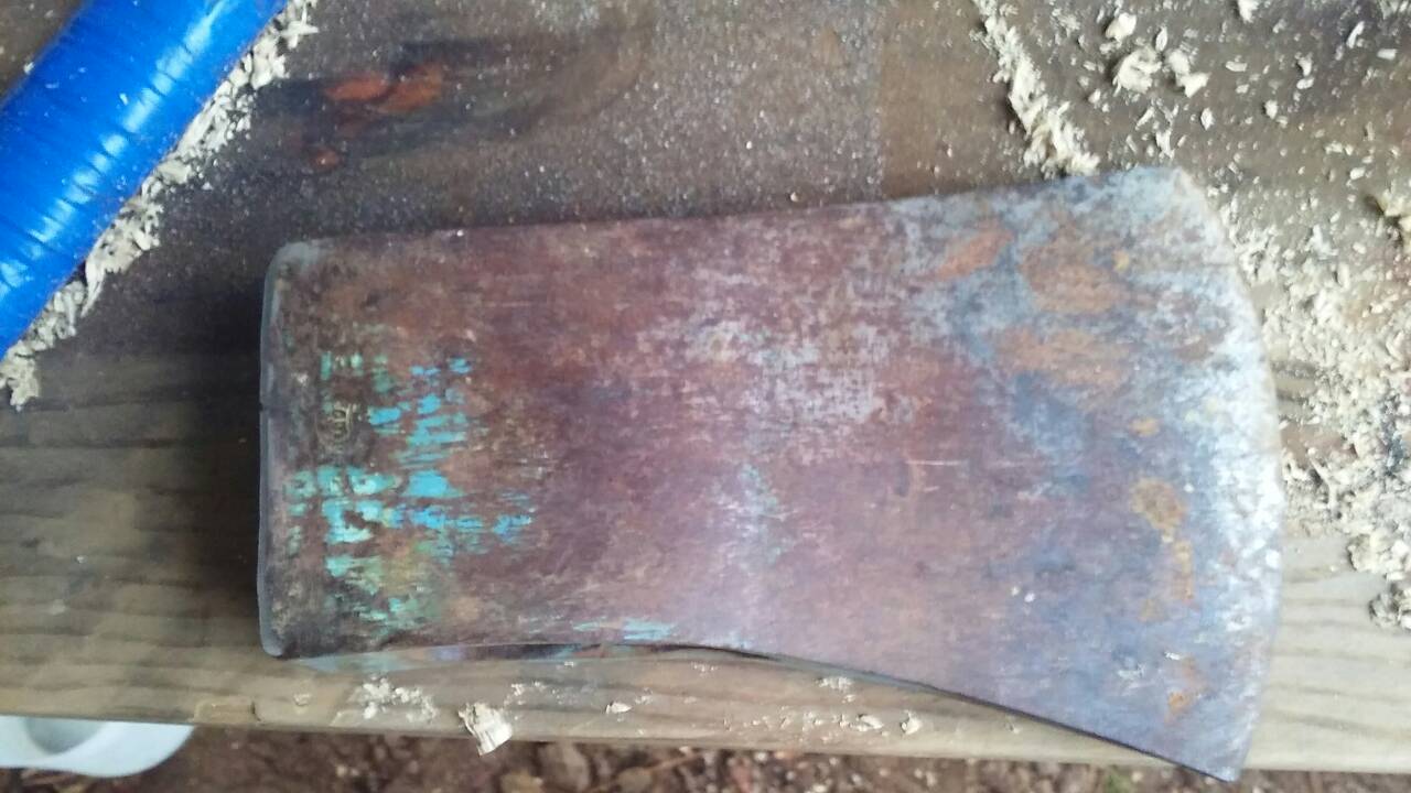

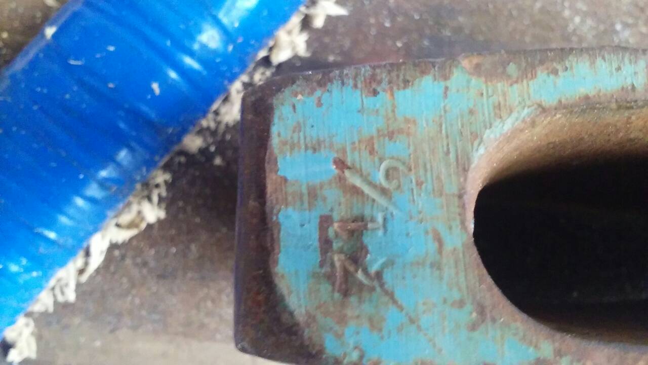

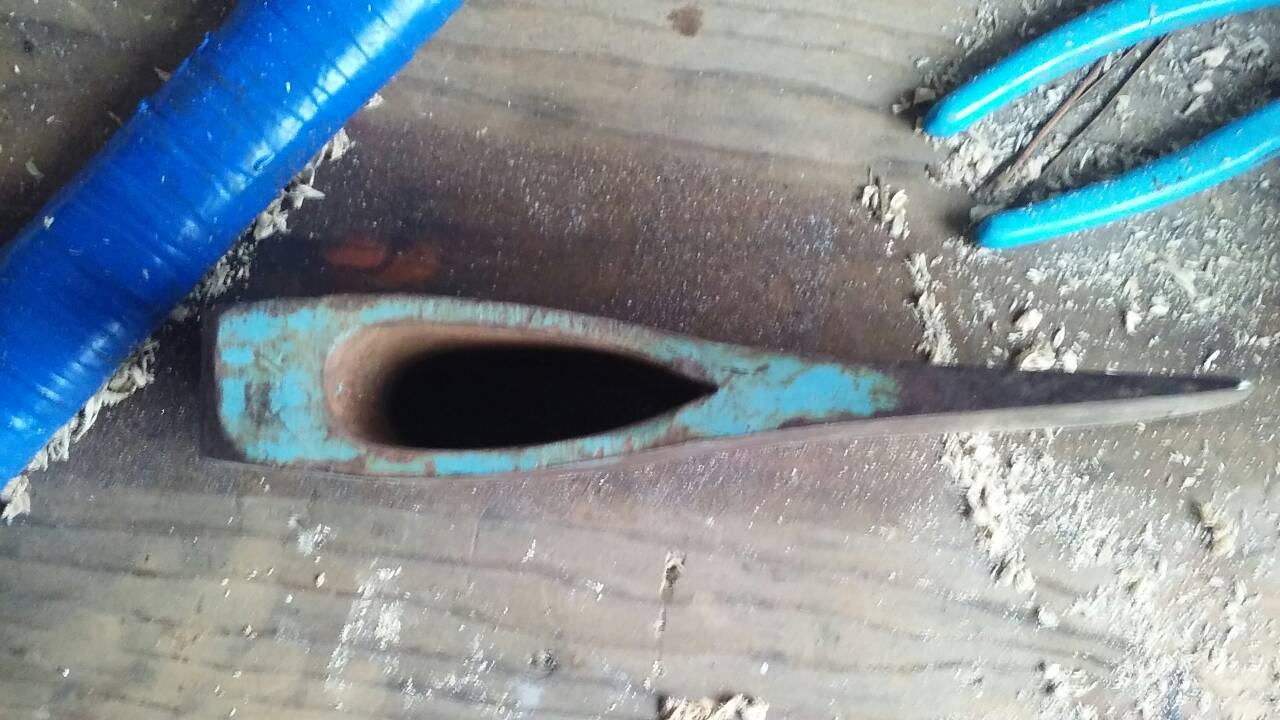

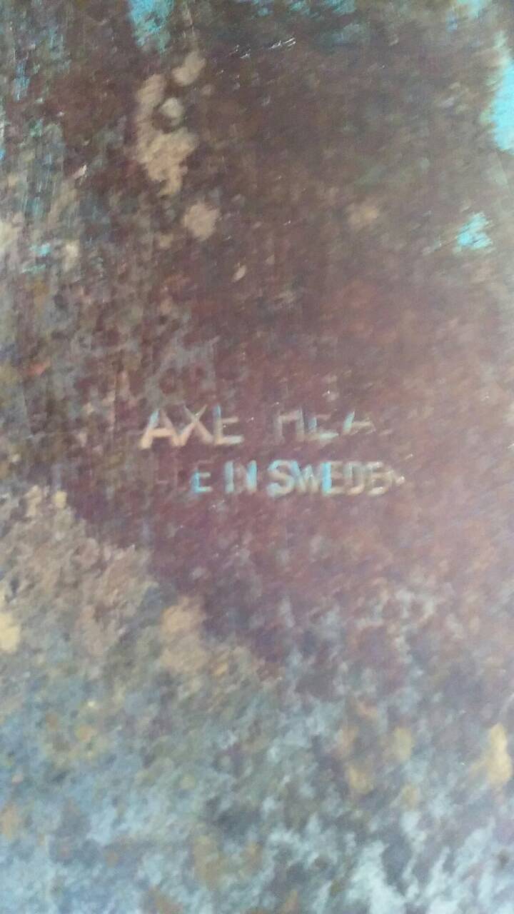

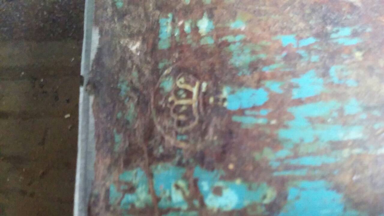

Hey all, I'm new here, I didn't see an introduction area so I figured I'd just jump in. I received this as trade recently, it was clearly made for US sale as it's weight is stamped in lbs (at least I assume that's what the 3 1/2 means.) It's in decent shape and though I haven't sharpened it yet it seems to be decent steel. It's in vinegar right now to remove rust and then it'll get fixed up and re hafted. Does anybody know when this may have been made or any other info? Thanks!

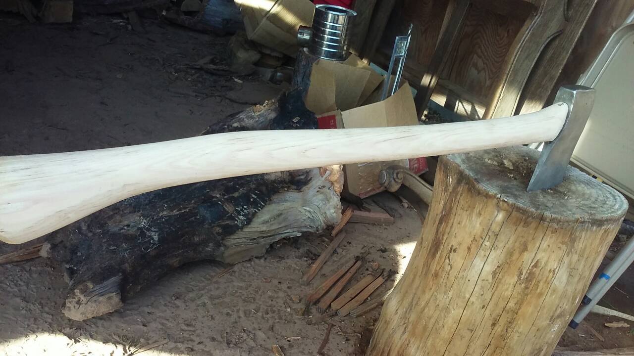

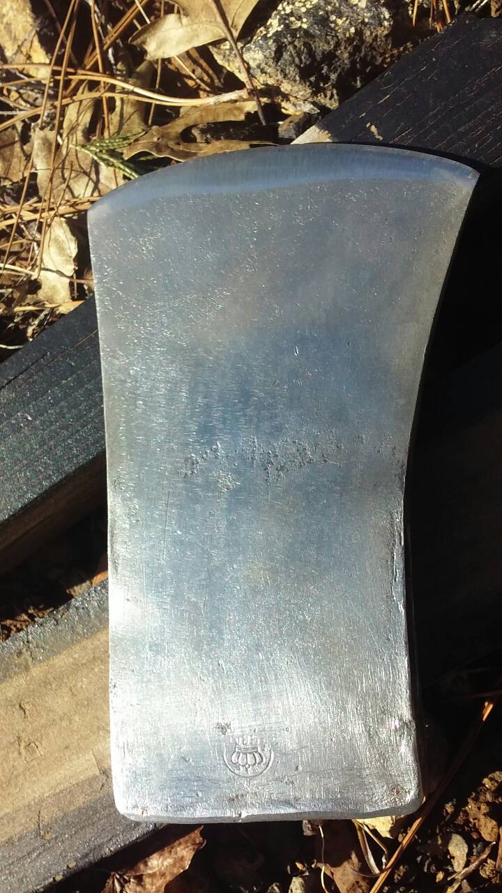

I removed the rust and paint and sharpened it up and put a handle on it. Pretty hard steel on this one.
Nice, back when GFB made no nonsense affordable axes for the US market. Should serve you well.

Likely manufacture is sometime after 1955 and before 1980. There were a wide variety of Swedish tools marketed (certainly in Canada) during the 1960s. They could compete against domestic manufacture but not with the influx of Asian goods that began to make huge inroads in the 1970s.
Great thanks! I had assumed '70s or '80s, but why do you say after '55, out of curiosity? Did something happen/change that year?

You did a very nice job of bringing that axe back to full utility, and painting is your choice, so don't let my opinion influence you. It looks nice as is and paint on axes is not fashionable these days, but I do like that color: it looks retro cool to me.
The global export surge of European goods began after WWII but it took many Countries and their industries time to rebuild/modernize operations and then to design and market goods. The n. American economy was booming by the mid-50s. No doubt some Swede axes trickled in before the mid 50s but my guess is that the majority of sales would have been later.
