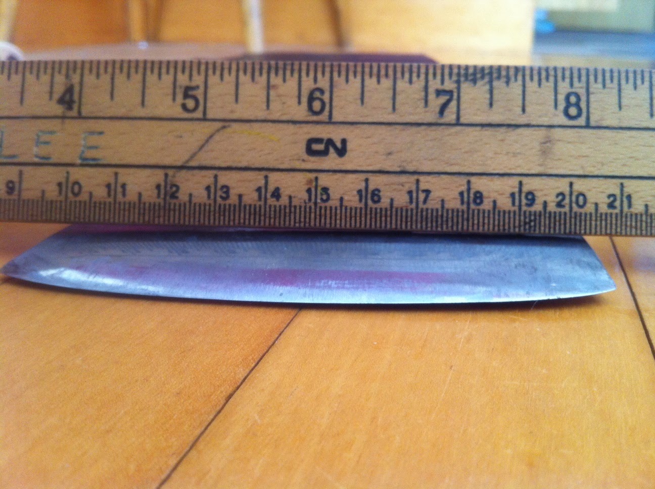

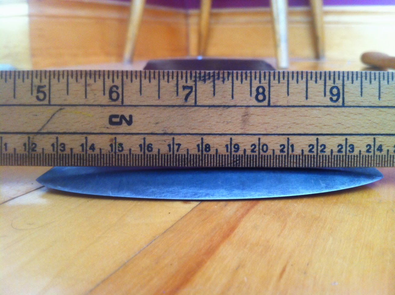

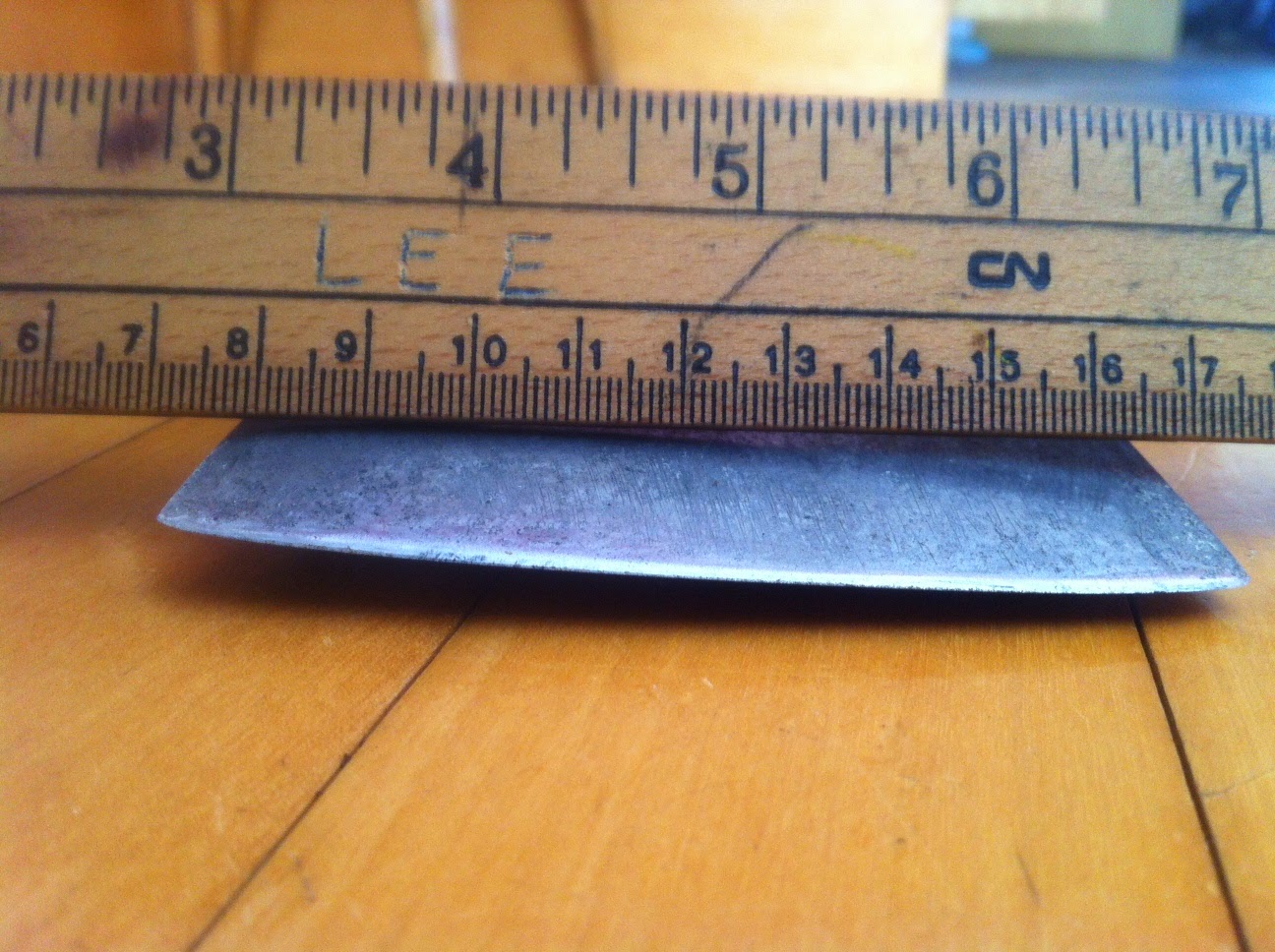

A big problem here is that people then go on to say that Gransfors are poorly designed because they do not have an arched bevel (high centerline). This is simply untrue. My forest axe has some arch to it, but a fair comparison would be the Gransfors American Felling axe. Here are four different axes and their respective arches:

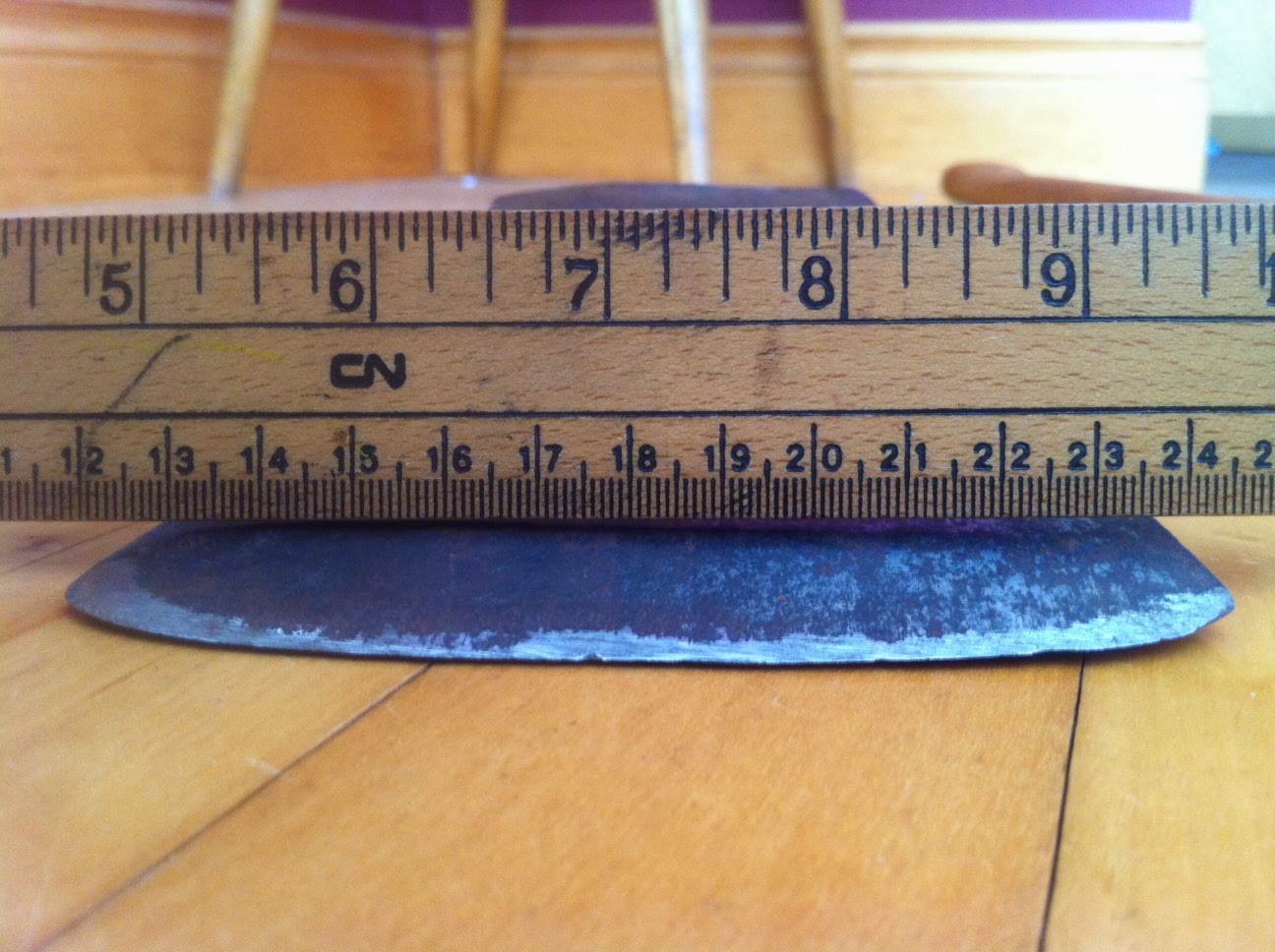

Emerson & Stevens (Not my profiling, one side looks as though it was taken down to match the other.)
Gransfors (factory profile, only ever used 2000 grit on it for light touch-ups)
Spiller (Edge arrived like this.)
Campbell's (Edge shows wear from storage in axe head crate, was an unused axe from 1926, never sharpened but obviously had minor dings from banging against other axes. Very hard steel so I'm just cleaning it up slowly as I use it.)
The Campbell's clearly has the greatest arched bevel, while the difference between the Gransfors, Spiller, and the E&S might be called insignificant. In Dudley Cook's book he says that most axes came from the factory with too much material, and that the material should be removed to almost flat. It seems that arching material in the bevel is up to personal preference, what trees one primarily works with, and what tradeoffs people are trying to balance. Some would say there is no significant difference in sticking between the axes that are flat and those that have an arched bevel.

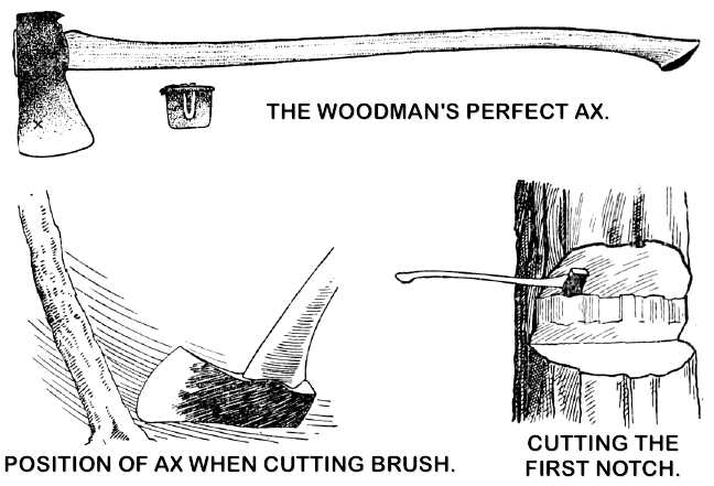

There is one important reference, however, in Woodcraft by EH Kreps:
"One of these rules, and the most important, is to have the blade or bit thinnest on the "inside corner," which is the end of the blade nearest to the user. The hasty conclusion would be that if this corner were thinnest, the opposite side of the blade should be thickest. This is wrong. The thickest part of the blade should be two-thirds of the way across from the inside corner..."
This is what the high centreline really is, it is primarily for balance. As far as I can remember Kreps doesn't go into detail about why this is so (I will check when I get a chance), so we have to wonder why most of the material should be two-thirds of the way to the outside corner. The most likely reason is for balance. When an axe is swung it is rounding, the force will not be in the centre, it will be close to two-thirds of the way to the outside corner. Think of racing cars, if a car must turn both left and right then the forces on that car will tend towards the centre, but if a car only ever turns left then the forces will always tend towards the right. The high centreline makes the axe balance towards its outside, preventing wobble.

If you look at the pictures used in the Axe Geometry writing the ruler is way back on the bit, in an area that would have no impact on an axe getting wedged in a tree. For the purpose of keeping the wood/chip from compressing and adding force to the edge it would not matter if the bit is flat or arched. That leads me to conclude that much of the idea of the 'high-centreline' is confused with the real purpose of the high centreline, which is balance. Axes can benefit from micro dips of convexity in the middle bit, an increased concavity here, and a ground edge there, but at that point we're getting into nuances which probably only benefit those with perfect swings anyway, or the racers. Other aspects of geometry are more significant for general use.

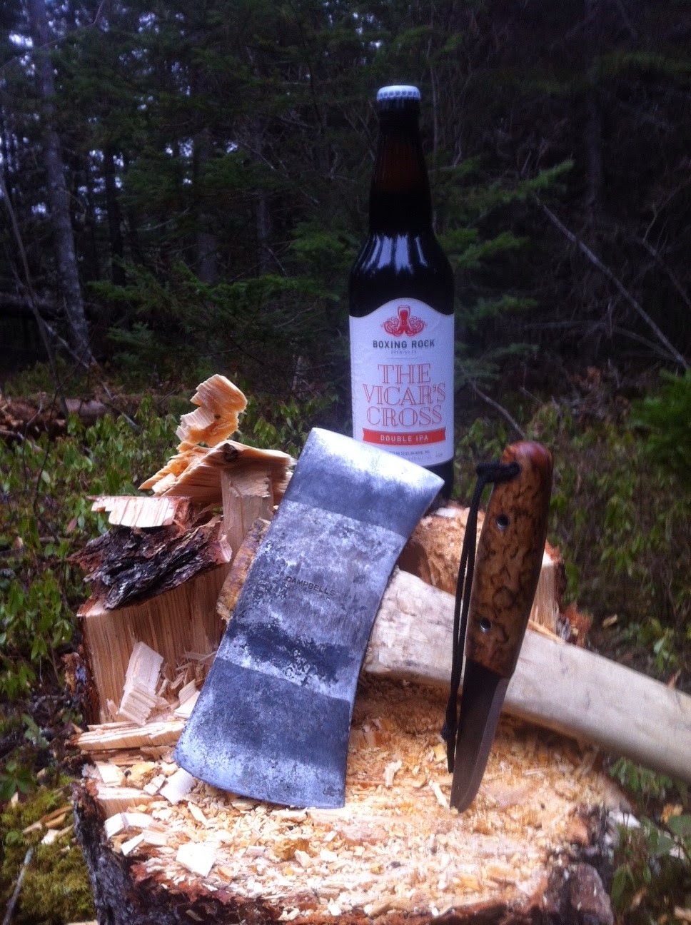

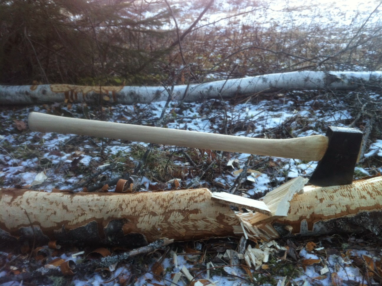

Here are a few more pictures of the axes I'll be using:
You can see how poor my handle skills are compared to the others here, but I did it with only an axe and knife and it was my first try hafting as well. If anyone has thoughts on the age of the Spiller, or how much material you think it has lost let me know. I'm guessing around 1/4" or a little less, but I'm not as experienced with Maine axes as some here.
Some trail/road clearing.
This one was rotten in the middle and made quite a mess. Pictured with the knife I carved the handle with and a nice drink (deserved I think after a rotten tree hangup).

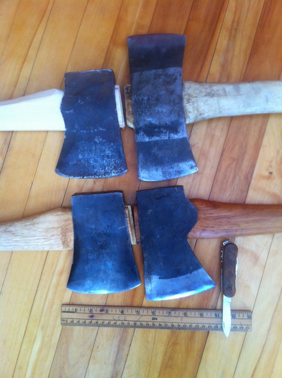

I would also like to hear if anyone knows the label or pattern of the E&S as it is the exact dimensions of the one described in The Ax Book, except the poll (I wonder if this was a mistake on the drawing since both the Spiller and ES have wide polls).
A couple things I forgot to mention, the profiles of these axes are all very close. One thing with the Gransfors is that they do not thin material behind the heel and toe. Many other companies/individuals do, and when looking down at the profile this gives the impression that the Gransfors is significantly more flat, when the photos I have shown suggest there is very little difference. The thinning at the toe and heel makes it seem like the difference is greater than it actually is, while providing no benefit, nor an increase to the bevel arch. Thinning too much material behind the toe and heel is also discouraged by Dudley Cook since it increases the risk of damage.
As well, much of the pop intended to dislodge a chip comes from the angle used at the primary bevel, as well as the technique used to help pop the chips. I think this is more significant than an arched bevel given that the area behind the primary bevel should have no significant force on the chip anyways considering it is in negative angles at that point. The concave intends to relieve force against the wood, not increase it.
