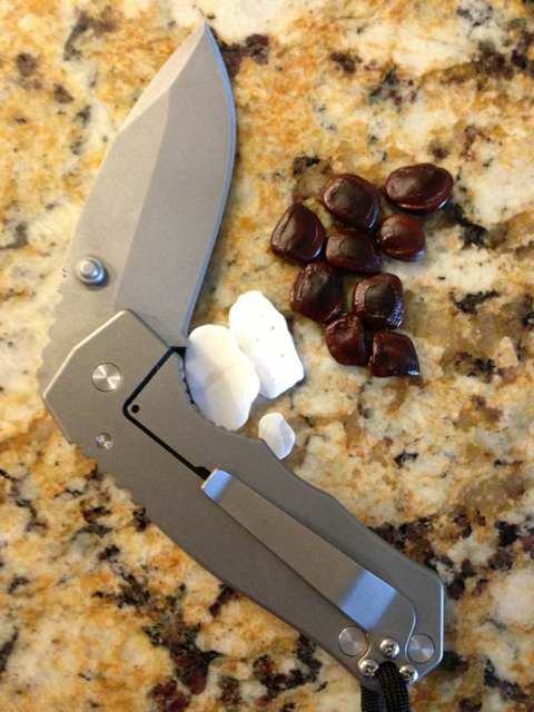

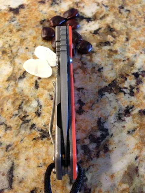

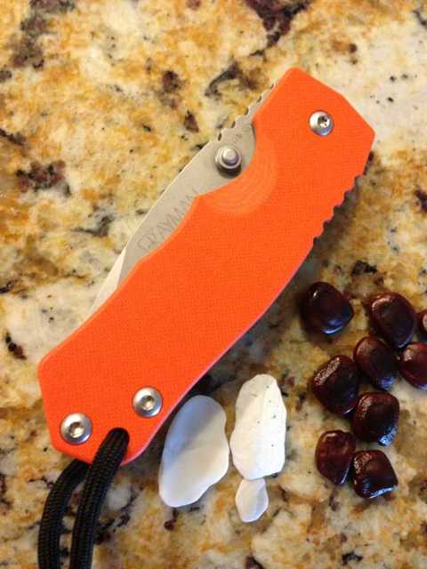

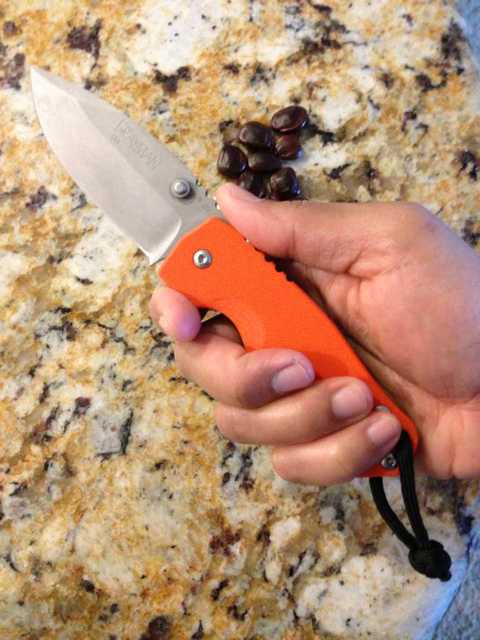

Oooh...my Dua is on its way, orange handle one. Shall post some shots in a couple of days, if the OP does not mind. :)
Photos...
