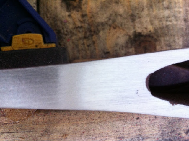

The heads take a lot of work, I start with 40 grit grinding discs and remove all the paint and rust.
I continue with 40 grit getting all the pits and paint off
Here is a before and after of the first two axe heads
The top and bottom of the axe head require clamping the head to a board, a vise would work too, I just don't have one.
From this position I grind then draw file then sand the top and bottom until the lines are nice and even
Once the top and bottom are nicely finished I go back to the axe faces increase grits going from 40 to 120 to 180 then it is all hand sanding and polish

Nothing in the post is super ground breaking, for me, what is impressive is how easy it is to do with very few tools. The drill sander/grinder works extremely well. It is a 4.5" circle and I have found that I can force that shape into the taper of the axe head resulting in a head that cuts very well, is well balanced and looks good as well.

Getting a high polish on an axe head by hand is no small feat. I started with the power sanded head, then hand sanded from 100 grit to 600 grit. Then Mothers Polish with scotch brite pad, then more polish and a buffer attachment for my drill.
