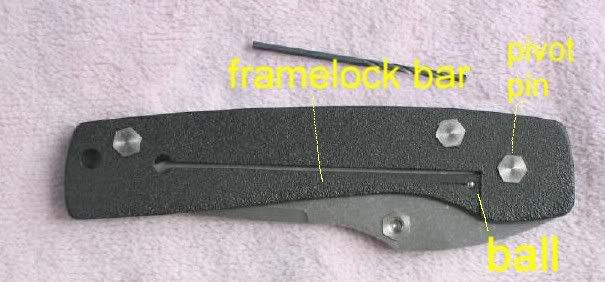

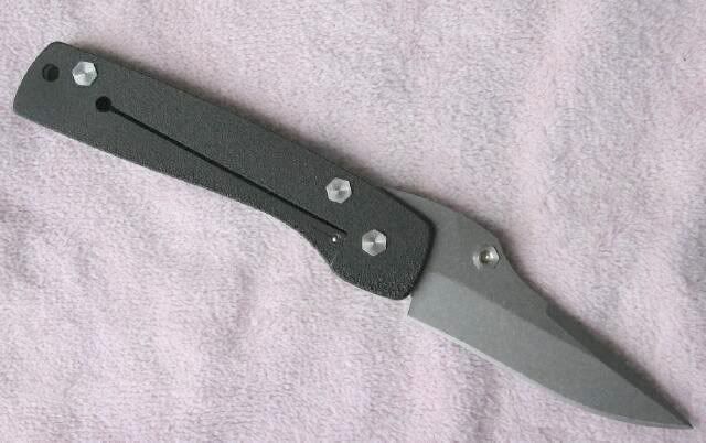

- There's a ball in the frame lock that is positioned so the blade rides on the ball. NOT on the rail. The ball is positioned in the framelock bar and has a slit so it is adjustable.
I got an appropriate size punch and WITH THE BLADE IN THE CLOSED POSITION, reseated the ball so it rode in the detent (or scalloped hole) in the blade.
I can see where repositioning the depth of the ball has released the drag from that area of the blade.

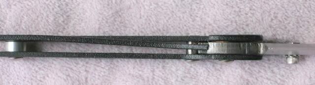

When I close the blade I can see that the framelock scrapes or rides on the blade. This isn't supposed to be. Someone possibly tried to change the framelock bar position or it may have come that way. They may have done this without knowing what the silver ball was for.

pic of the framelock side with ball

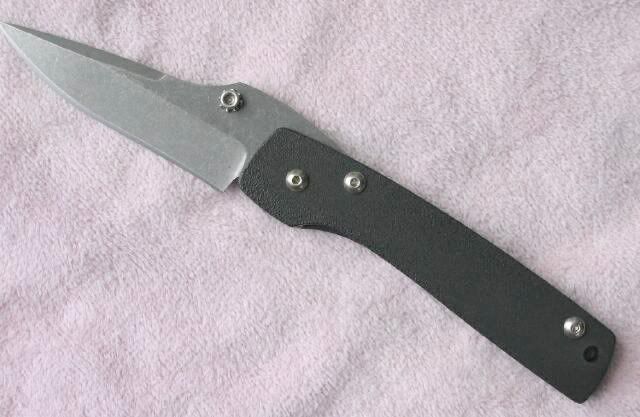

This is one tough motha. I like it lots!
I think the thumbstud could be reversed with little effort for lefty's
Lockbar riding center line of the blade for the most strength
