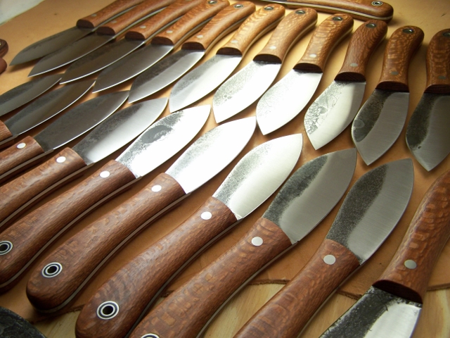

I make them in both Scandi and convex. They'd work fine with any grind. They key is to use thin steel. Sears wrote critically of thick bladed knives, and mentioned his being thin.
This is the first 25 I sent to AG Russell.

I like them because they are the anti-tactical knife. Really as far from it functionally as you can get. Also, I like folks that like using thin bladed knives. Thats something I've always keyed off of. I make my Nessies out of 3/32 thick steel the vast majority of the time. (01, btw) When I make that larger one pictured above. (Thanks Foxx. (stabalized curly Hickory for the handle)) I use 1/8" thick 01.
I always check out a makers Nessmuk designs. Its a real canvas to create with. Necessary traits IMO (worth very little) are thin blades, edge forward of the fingers, rounded spine hump, sexy curves to the overall shape, and a nice thin edge. The knife was a slicer.
