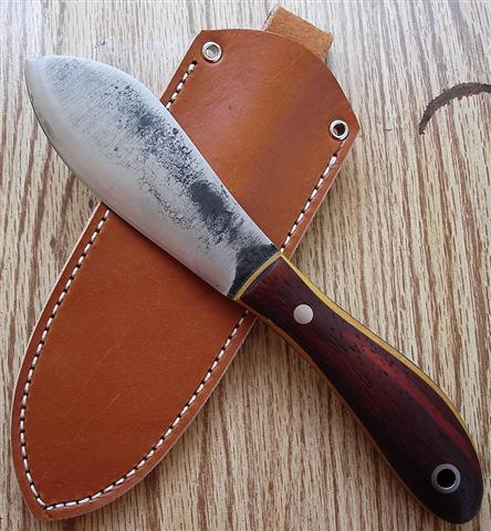

Additionally, often convex grinders make aesthetic mistakes. Little dimples in the spine at the plunge, where they've pushed the belt into the spine by mistake. This pic is of an early Nessmuk I did. You can see this aesthetic flaw perfectly on this knife. It took me 300 knives before this mistake was conquered, and the convex sabergrind was born. (Dylan's sorry ass mastered this after only 25 or so knives.)
