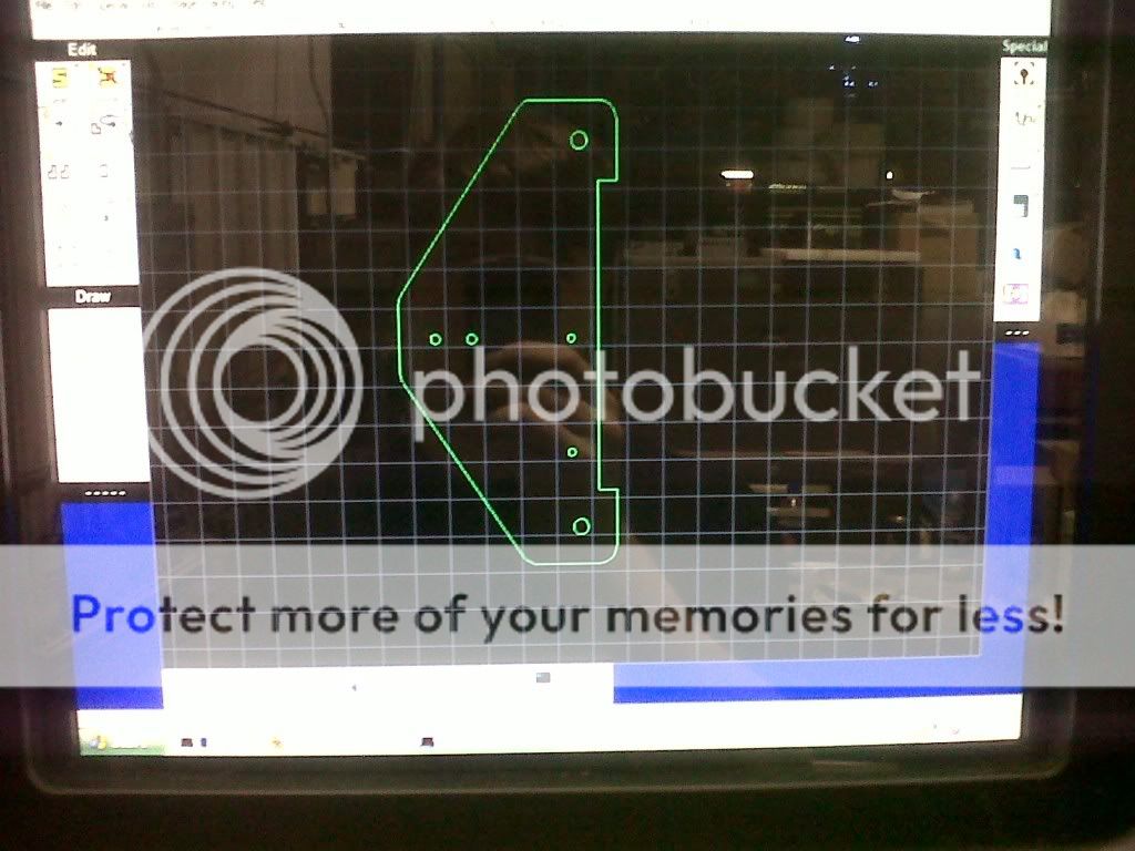

Start out by laying out the part in the drawing software.

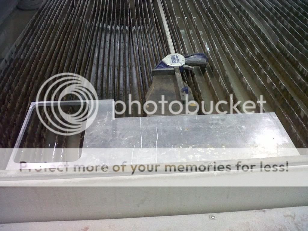

Then get your material loaded and secured, in this case I am using 1/2 inch 6061 aluminum plate.

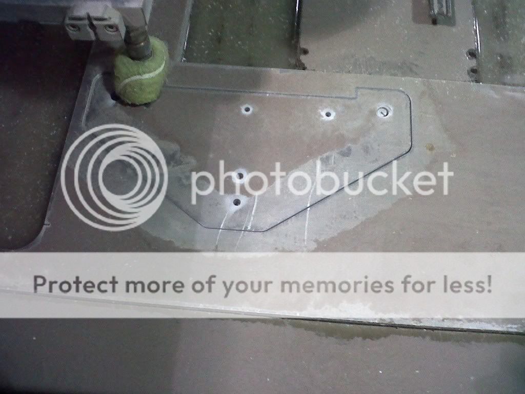

Then you position the head in place, flood the table to keep noise and splashing water down and click the go button. About 4 min and 12 sec later you lower the water level to reveal a very sandy part.

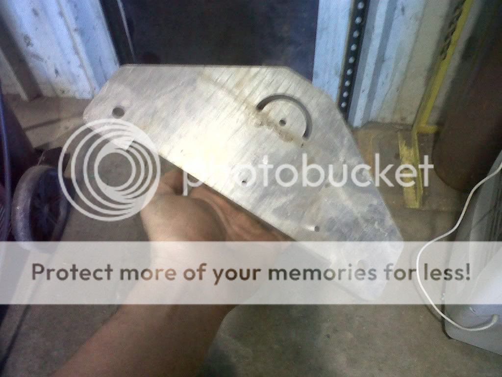

After washing off the sand and blowing dry, I completely forgot to cut the slot in the first one to allow changing angles but I will throw it in the Hass and fix that issue at a later date.
