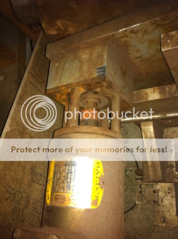

So I picked up this grinder for dirt cheap sight unseen.
Untitled by rlibson, on Flickr
The wires have been cut and it's missing the control box?
Are control boxes manufacturer p/n specific or are there generic switches that I could wire up to see if the motor works?
I don't have the specs of the motor at hand - it's a baldor of some sort.
I'll try and update the thread when I get home and get a better look at it.

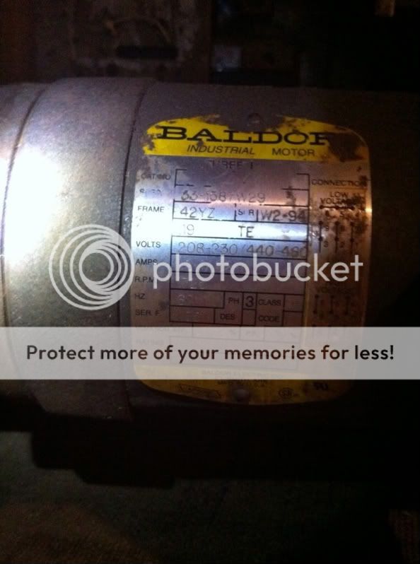

If you're lucky, it's 1 phase. Unless, that is, you have 3 phase power (not likely) or wish to run it with a VFD.

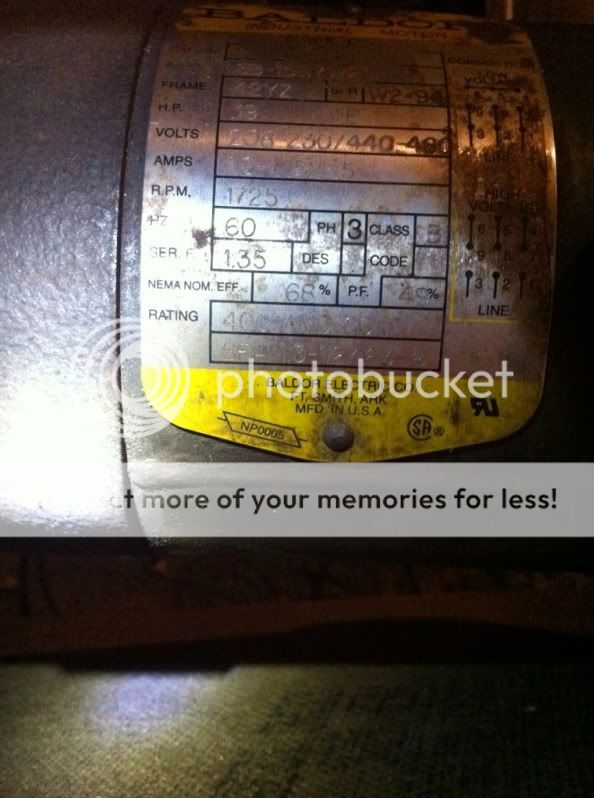

The motor plate should tell you what the phase, horsepower, and voltage are. The box on the side of the motor will likely have a diagram on the inside of the cover when you take it off. There will likely be six or nine wire leads coming out of the motor into the box. They will be combined into two or three bundles, which in addition to the ground wire will then be routed to your power supply. The wires should be numbered, and the diagram you hopefully find should tell you what numbers of wires to combine for high voltage, low voltage, and reverse operation. Have a look in there.
Some more photos - don't know my way around these things really at all - but I'm guessing 3 PH means 3 phase.
Tomorrow I'll have more time to pull the cover off the box, remove the guard/tool holder dealie and have a better look.
You've got your wiring diagram there on the side of the motor plate. That is a 3phase motor. You don't have 3 phase power, an inverter, or a VFD do you? It does appear as well that it's a fractional Hp motor... .19 Hp? If so, it won't be of much use to you for grinding steel. At least retrofitting a larger motor wouldn't be hard with the c-face motor and Lovejoy coupler.

Can you verify the HP rating on the existing motor? It isn't clear in the photos, but looks like it says .19 HP??????

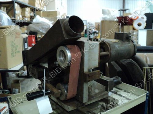

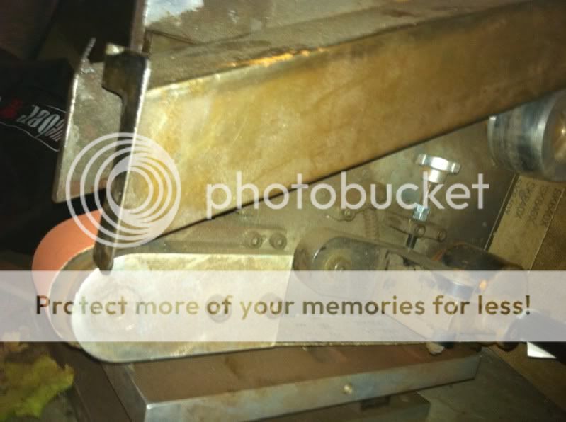

The grinders interesting, and is not one made for knife grinding. It has a small contact wheel and a large dust collector. I thing it was a specific use grinder for some industrial purpose. The small contact wheel is going to limit its use to some profiling tasks. The way it is setup, you can't really install a larger wheel without modifying just about the whole grinder.
Some questions-
Is it mounted on some sort of slide base?
What size belt is one it?
What is the HP of the motor?
Roughly what does the whole thing weigh?
Salem is right .19 hp must have been grinding something soft.
Heavy maybe 150 lbs, the whole shebang slides back and forth and perhaps side to side on a base. I haven't pulled or measured the belt but it appears to be 2 or 3 inches wide.
Definitely purpose built for something although I have no idea what?
Although... is that a gear reduction box the motor is driving? Might slow your belt speed down too much if that's what it is. A possible solution in that case would be to retrofit with a 3650 rpm motor, or use a bigger drive wheel, or both.
Slow speed is good for already hardened blades, particularly sharpening and stropping (running a leather belt). The slow speed retards heat build up (which can ruin the temper). Obviously if it's your only grinder and you do a lot of stock removal, then go for the faster motor. But personally I'd keep the reduction gearbox, up the power on the motor and use it for putting the edges on after HT and reprofiling.

0.19hp? Can't you tell exactly what hp a motor is by the amps it draws, knowing everything else? It looks like maybe it's a 4x48 with a 3" belt on it to me. I just can't see an underpowered machine here. It's industrial in every way.

That motor on there is rated at 1725 RPM I would not put 3600RPM motor on there are guys that make phase invertors on ebay to use to start the motor.
It does look like a bigger motor than .19 hp. However, from what I can barely make out on the spec panel, the amp draws appear to be fractional too. That would tend to make me think it's a smaller fractional hp motor, as well.

Your answers were what I thought they would be.
While I can only speculate what function this did in a factory, the basic process was:
1) To slide forward and make contact with some material, probably plastic. This was probably done by a pneumatic actuator that kept a constant pressure.
2) Then another actuator, probably a screw drive, would pull the contact wheel down the material slowly and evenly as the belt cut a groove....basically an automated hollow grinder.
3) At the end of the cut, the grinder would pull away from the material and return to the starting spot.
Sadly, because of the way it is made, it won't be able to do much for you as a knife grinder.
Since you haven't filled out your profile, no one can volunteer to come over and look at it and offer advise on modification, or trade you for something you can use.
Modifying it would be difficult and expensive.
