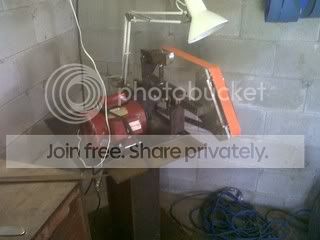

Got my grinder finished up and in location this weekend, have not really gotten to use is much but it runs great. Now I have alot of practice ahead of me to get good at grinding blades.
I have one question about the belt location during grinding, where do you want it to ride in relation to the edge of the platen to get the best plunge lines?
Nice work man! I need to build me one of those to replace my craftsman :p
As for the belt, I typically run my belt about 1/16" off the edge of the platen which works for me. Maybe someone else can concur with me so I know I haven't been doing this all wrong?
