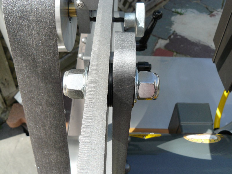

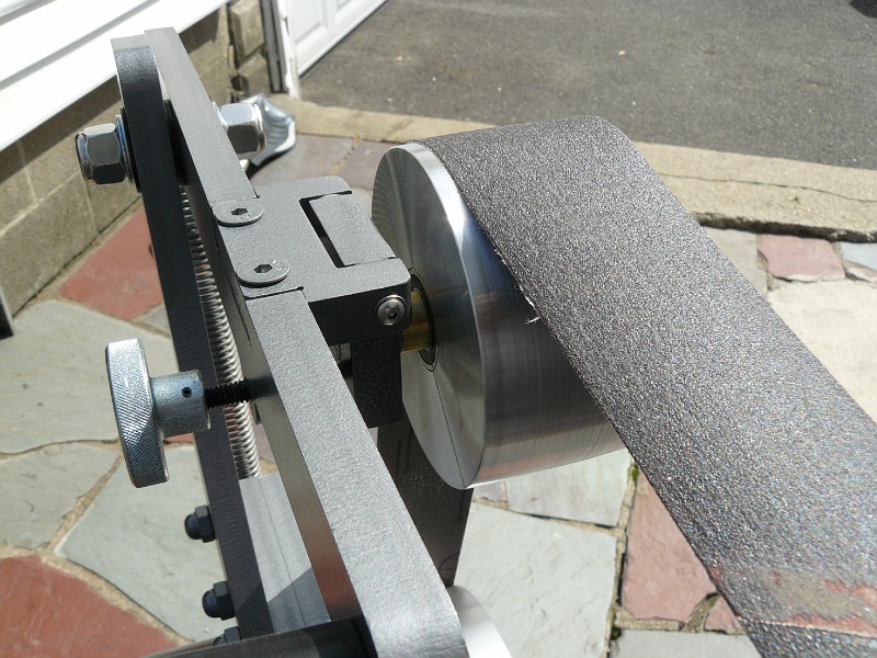

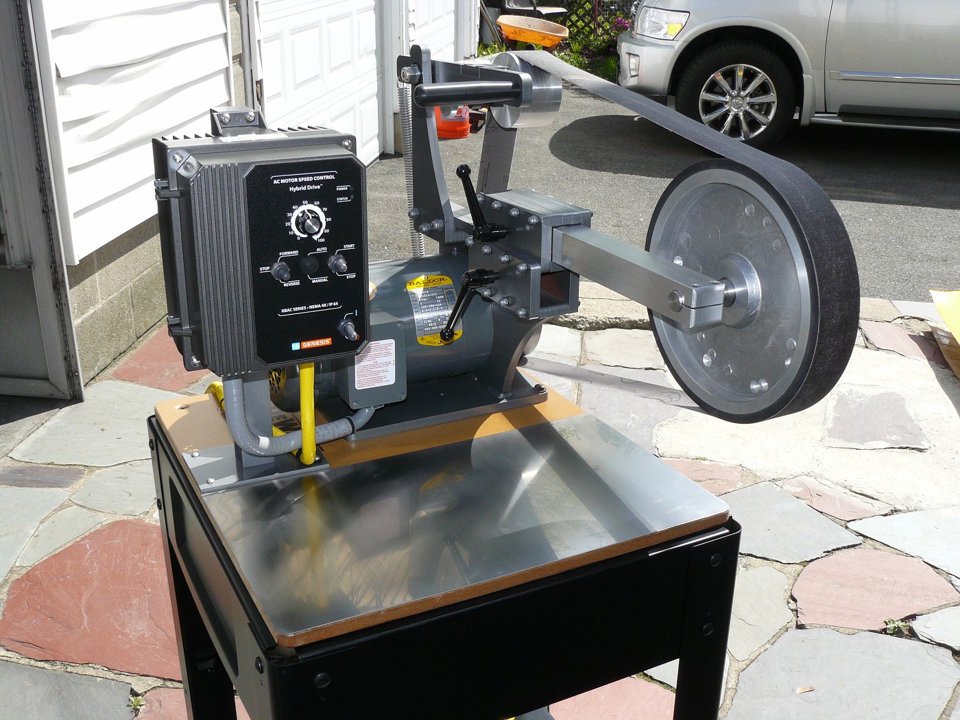

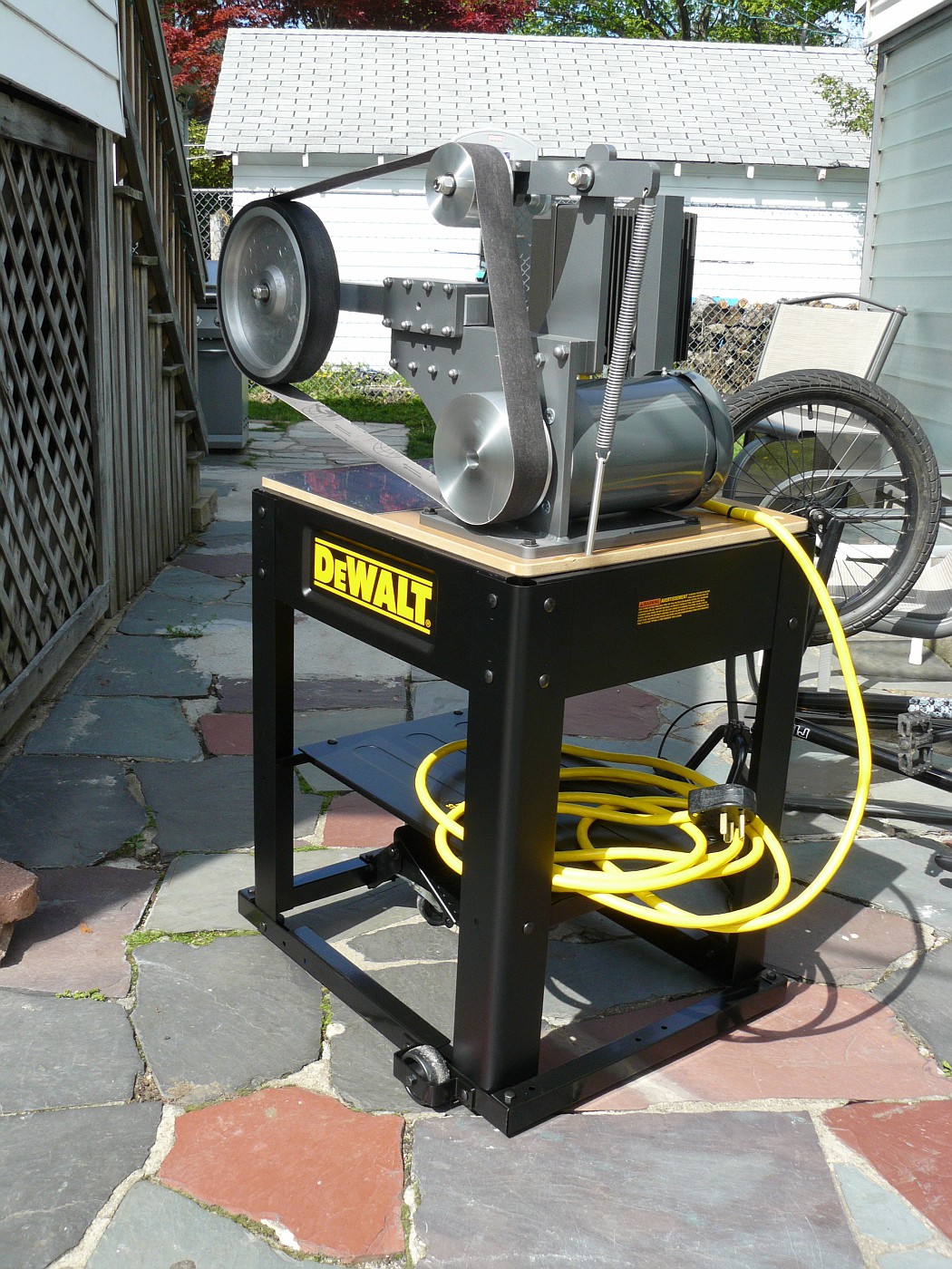

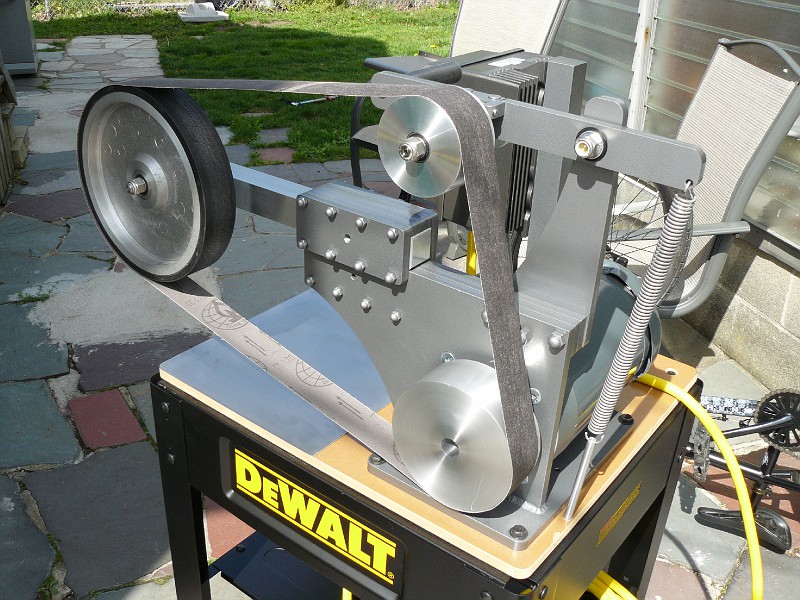

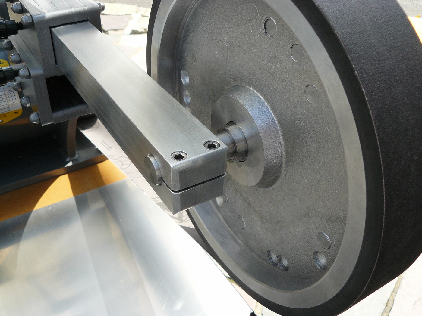

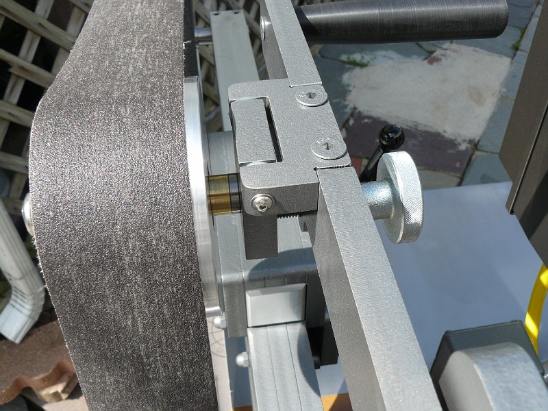

I finally completed my Grinder in a box build. I'm a perfectionist so it took longer that expected :)
-Precision shafts on all bearing sufaces and tracking assembly
-Modified Grizzly 10" Contacy wheel (Bearings Added)
-Home built 6" Drive pulley and 3" tracking Pulley
-Delrin bushing added to the tracking arm
-Dewalt Planer cart works nicely

Give us a break down on the Grizzly 10" wheel and what it took to get it installed.

The grizzly wheel as it comes needs to be bored for bearings which requires a medium size lathe. If there is interest I could offer the Grizzly 10" wheels with the machine work completed and bearings installed.

Where did you get the precision shafts?
