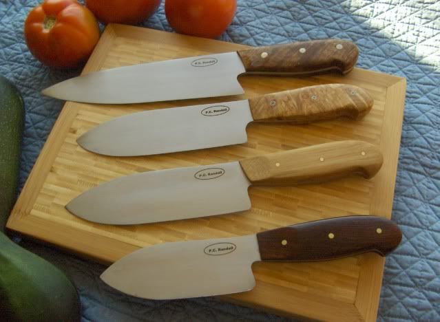

Here is what I do, flat grinding on a Coote, but I sharpen with paper wheels. I prefer a wide blade, makes cutting easier and give a very sharp angle to the edge for better slicing. These are ATS 34 stainless which holds a great edge and will not stain or rust.
