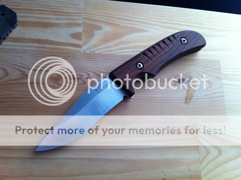

Hi, metal experts. I have a quick question. I'm thinking of grinding or cutting some metal off a D2 blade to make a shorter knife. Is the process going to heat it up to the point where it loses some properties or is it safe to do? Thank you.
Depends on how you do it my friend. Light reprofiling can be done on a stone. In this case, you don't have to worry about overheating. If you are using a grinder, be wary of making it too hot. You should use some form of wet grinder in order to not EFF up your heat treat. The guys over in the maker forum would probably be a better place to seek answers.
If you want to grind it i recommend having a bucket of icy water next to the grinder,every few seconds dip it in there if you dont want your temper to be gone,if the blade isnt coated observe the color,the safest bet would be to make sure that it doesnt change at all.Take your time and dunk it in the bucket often and i think you should be fine.

These threads always amuse me. You folks realize that virtually every factory-made knife available is ground after HT, right? :) It's just not that big a deal.
D2 is a good candidate for re-grinding, as the high alloy content helps it retain its hardness at elevated temperatures. Just use moderate to light grinding pressure and keep it cool by dunking in water every couple passes and you'll be fine. Be extra careful at the thinnest areas.
The real question is, do you have the tools to do it well, and what's your time worth? Might it be worthwhile to just spend another $60 on a slightly different/smaller knife? If an hour or afternoon working on a knife you really like is something you enjoy, by all means, go for it. Be careful... it's addictive.
I ground down a Bone Collector. Went slow, made sure there was no color change, and the temper is fine. Added cocobolo handles as well. I cut them larger than the original handles which I felt were too small.

Nice, that's what I had in mind. Only maybe shorter. I'll go for 3 1/4" or so.

Mine is about 3 1/2" now. I was trying to take as little away from the cutting edge as possible. Obviously your needs are a little different.
