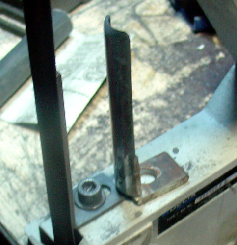

Ok so how do you folks do it? Preferably a flat grind. My best thought so far is that the corner of the platten might work, but I haven't tried it yet.
Wayne

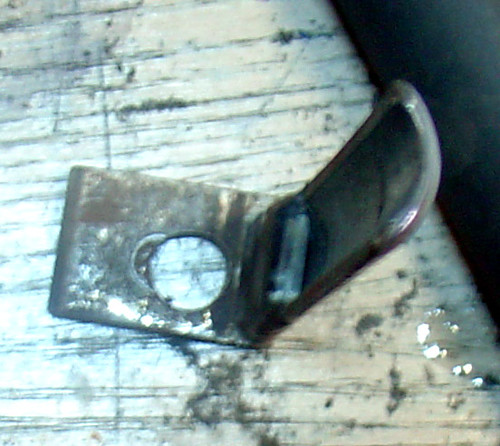

dont know if this helps but i cut a pipe in about half and welded it to a bit of angle iron i use this as the platten on flat grinds
im working with a 1x42 grinder and the same platten works well for finger grooves using a soft belt sorta like having a small wheel standing on end i can post a picture if you would like

yep next one i do will have less curve and by then the delta will will be just for handles i nee to get a 2x72 soon btw it helps to use a hi flex belt i like the 3m trizact stuff
i have used 36 grit stuff it just doesnt wrap around the platen well
I like the rounded platten. What I meant to ask about was grinding the bevel on a blade that is a sharp inside curve, like a claw form.
