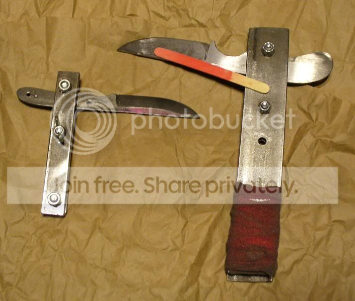

I think it is difficult for me to "feel" the angle of the blade as I ready it to push it onto the grinder. I made a blade holder that sticks out about 6 - 8 inches. This gives me a little more to hold onto and it's also helps me to visually see the angle of the blade in relation to the grinder. The blade holders were supposed to be grinding guides but I use them only as blade holders.
I also realized that I was rushing to make the grinds because I was afraid of getting burned by the steel as it heated up with the grinding. I was using the typical aluminum oxide belts from sears. I used some GOOD belts for the first time this summer and that was a real eye opener. They work so much better at removing steel and don't heat up the blade as quickly. A second thing I did to not fear a hot blade was to try using a push stick. It didn't work out so well for pushing on the blade but it ended up being a place I could place my fingers to push the blade against the belt. Now I don't have to rush and I can be more careful. The Popsicle stick on the large blade holder below is what protects my fingers from the heat.

It takes time to learn how to use your tools. What works for me may not work for you. Do what you can with the grinder then finish up with files. You will have saved a ton of time from doing it all with files, and you will see improvement with each blade you grind.
