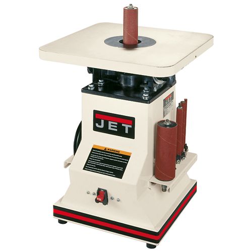

i've been using a plain old grinder to hog out inside curves and finishing up with a dremel followed by hand sanding out the irregular dips and indentions. there has to be a better way. what is it?

Oscillating Spindle Sander

Oscillating spindle sander

I've got 2 Harbor Freight spindle sanders and I've used em hard for years. They've worked well for me and lasted. I think they were $139 ea. If one died I would buy another one tomorrow. Supergrit.com has a great selection of the sleeves in the widest variety of grits I've found.
I have a ridgid model spindle sander that I got at a garage sale a few weeks ago. Seems to work OK for profiling steel, but you aren't going to find many abrasive sleeves for it other than A/O. I use mine for roughing curves in handle slabs, easier than files/hand sanding in that sense.
