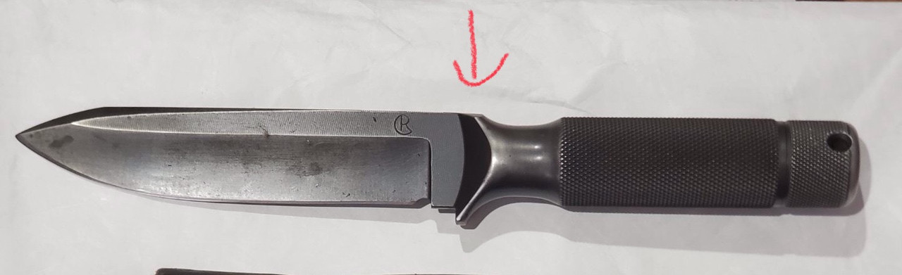

This is the blade I’m hoping to recreate:

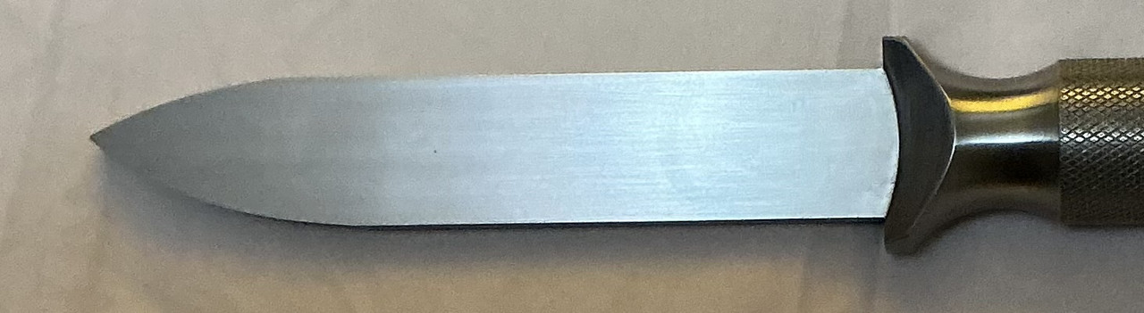

My progress so far:

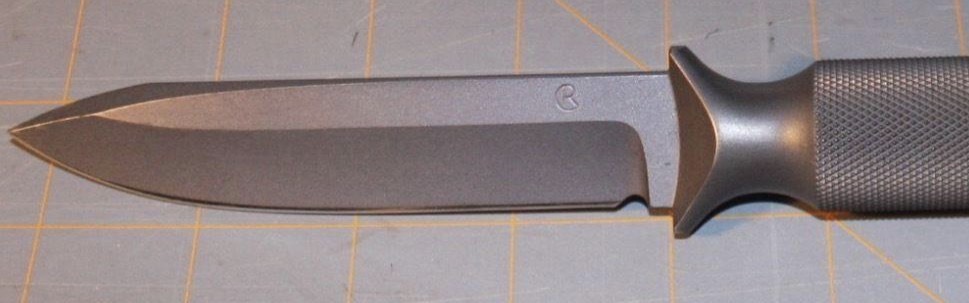

Here's my CR Shadow. It saw a lot of use as my hunting knife a few years ago.
My only complaint is the handle ices up with water and blood when field dressing.
It was a custom I had them make because I wanted a single guard
Beauty, I would love to find a 4” (shadow III) but they just don’t seem to pop up around here. Seems like the aviator is the most common one I come across and I’m not a big fan of sawteeth.
I would have loved to have had one to look over and measure when I started, but I just went off the general specs CRK listed and online pics. I believe they must have done some hand shaping around the guard, mine is as machined and the lines are sharper with some hotspots where the CRK appears to have softer more rounded edges - but without actually holding one it’s hard for me to pinpoint exactly what they did.

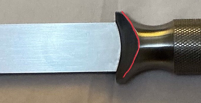

First off, thank you for the help. That said I’m not sure pictures will help in this situation- I think it’s one of those things that a guy needs to hold and look over. But it’s the line formed when you machine the blade flats into the round handle.
In pictures that line looks more pronounced on mine than real CRK. I think they must have done something to soften that edge.
I’m just not sure if it was machined, or hand done. It would surprise me if it was hand done, because of the extra time they would have spent blending it - but I also don’t see a super defined line that would indicate that they machined that transition. Just one of those secrets a guy wonders about… make me appreciate the CRK.

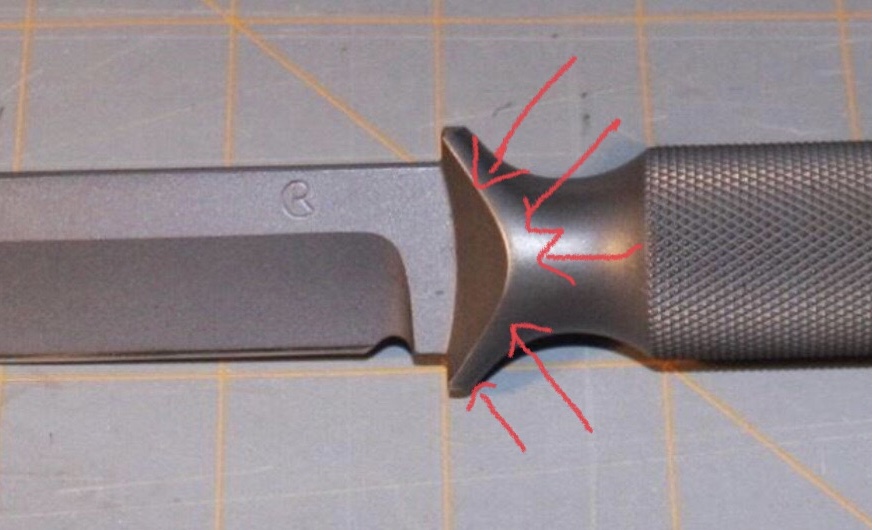

If it’s not too much to ask, maybe a picture straight down of the guard area of your shadow would help.
I have a 4" bladed Mountaineer I with the single guard and upon close inspection I do believe that line was blended out by hand. I can see a slight change in profile from the machined surfaces. There is some slight rounding on the end which makes me think it wasn't done in a machine. It is very nicely done, however.
I was about to say the same thing.
There is a slight variation from one side to the other.
A little blurry but you might be able to see the left side extends toward the handle slightly more.
I'll check with a micrometer later

Okay I put a mic on it. The right side was sanded more than the left side which moved the shoulder towards the blade. The middle red arrow on the photo you posted earlier is of the left side but that shoulder is what I'm talking about.
I'd say it was done by hand.
