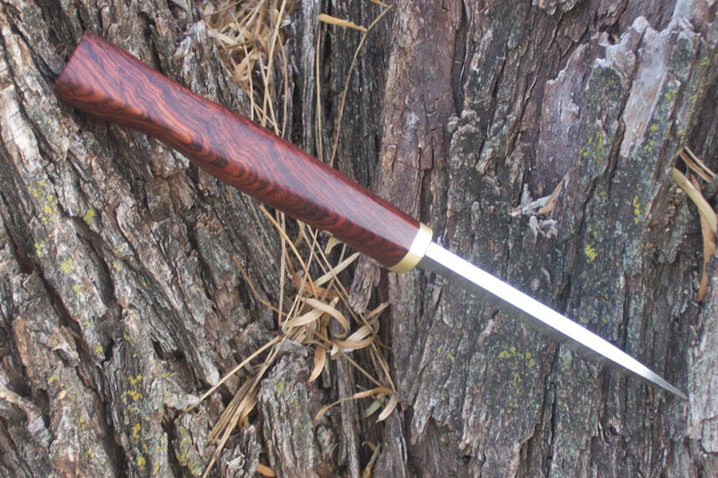

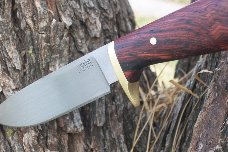

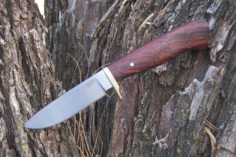

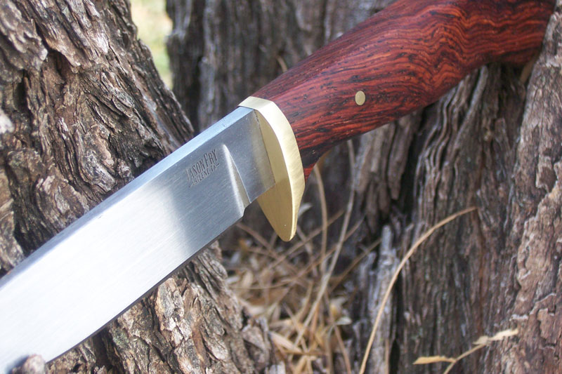

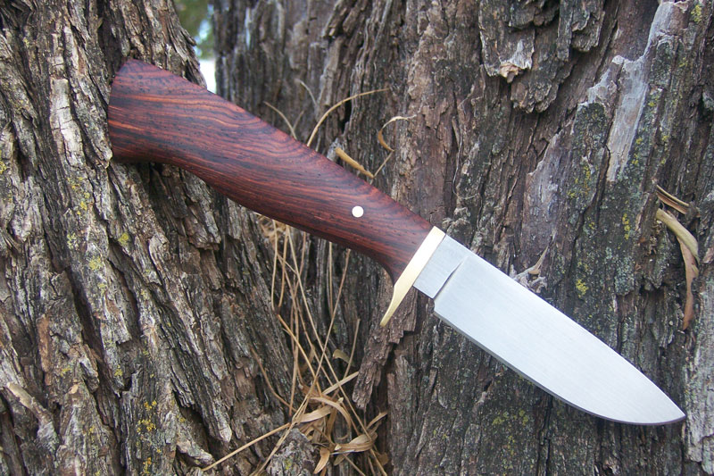

Here's the "Not Forged Hunter" that resulted in the rant a few weeks ago. I haven't fired up the forge in nearly two years, but I still like to make a stick tang hunter once in a while. This blade is 3/16 1080 carbon steel at 60 RC, shaped by stock removal. The guard is brass (nice fit!) and the contoured handle is some good striped cocololo.
Very Nice.. I am getting ready to try my first stick tang hunter just like that. I will be forging it though. Nice clean job !
