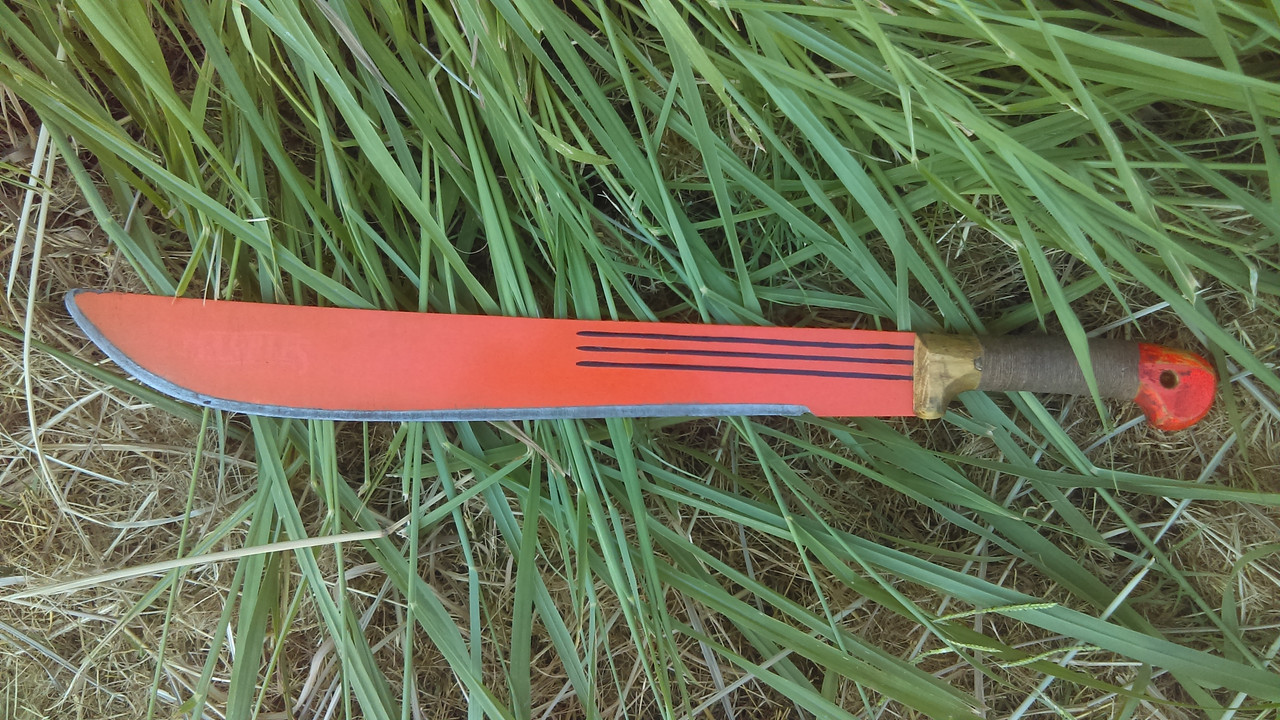

What I did with my machetes is give them a cotton twine wrap then coat it with melted beeswax.
It'll absorb it and it'll help lock the whole thing togeather.
It's natural materials as well, and in my opinion natural materials feel best.
