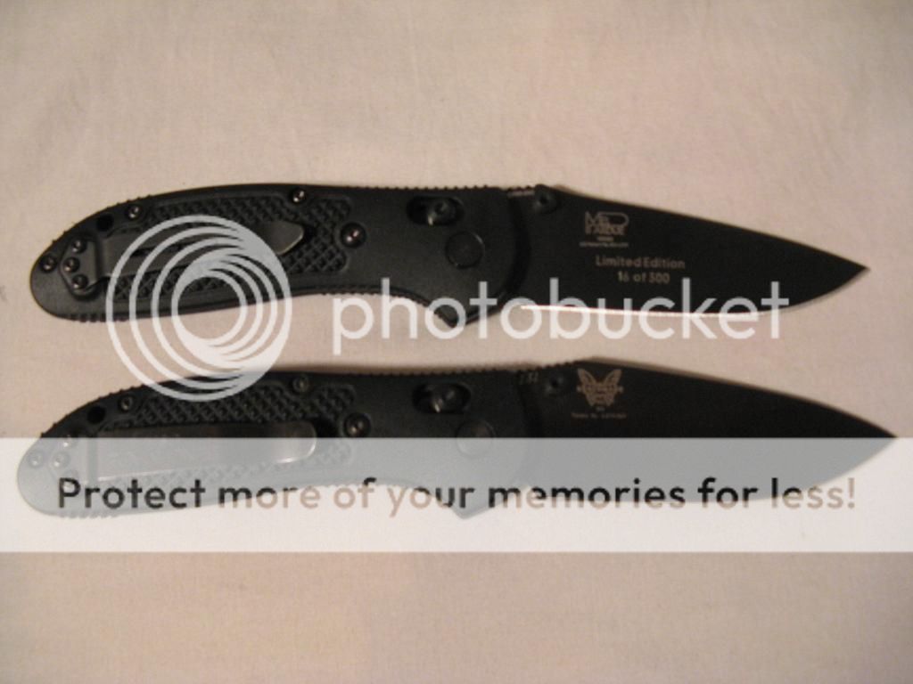

Some like the Ritter (552) Grips blade profile better because of the higher grind (closer to a full flat grind) which slices a little better, it doesn't have as much of a point as the 551 though. I have one of each both in CPM-M4, and while I slightly prefer the Ritter grip's blade profile I much prefer CPM-M4 to S30V (especially since Benchmade recently upped their target hardness from 60-62 to 62-64 on their CPM-M4) so for me I'd definitely go with the M4 option. Another reason to get the M4 version is that it is limited and you won't have it as an option down the road (at least not at its current price) while the Ritter is standard production and you can pick it up later if you decide you absolutely hate the 551's blade profile.
