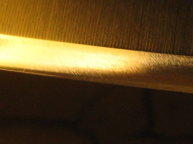

I will correct myself now on two things, first I had 8000 stuck in my head when really its more like a 4000 grit finish, thought with some steels my 8000 grit waterstone and DMT xxf do produce very similar finishes. I sharpened some INFI the other day and for whatever reason the DMT XXF was leaving the finer finish than the waterstones but when I sharpen ZDP the waterstones win. :confused:
Second, the picture I showed in the last thread of the finish that a unlapped stone produced was not that great, I found a picture of the finish my UF ceramic produced before lapping. This is the finish my UF ceramic produced before going back to spyderco.
An this is the results after it came back.
Re-finished it because I was unhappy with its original surface finish, I felt the mill marks were effecting my sharpening and I also suspected that the surface was not level.

Try to imagine in your mind what would happen on the surface of an abrasive if it were lapped or milled. Do you think the abrasive particles would break up into smaller pieces and stay connected to the sharpening tool? That isn't possible, obviously. If you broke up the particles, they would detach from the matrix. The only thing that can possibly happen is that the particles become smoother by cutting off their tops. They are the same size - perhaps a little larger, in fact, because the parts that were cut off were likely of smaller diameter than the parts that were left behind. I hope I'm explaining this reasonably well.
If you accept that the abrasive particles can't be smaller after lapping, then explain what would cause them to leave a shinier finish on the edge. Do the particles "scratch" less because they are smoother? If they do, then how would the scratches be smaller since the particle size is the same or larger? The fact is there isn't any way that I can imagine for this to happen. Physics and geometry don't allow it as far as I can see.
Perhaps you have some experience with leather stropping. If so, you know that it is possible to drag a sharp edge across the surface of a piece of bare cowhide and see an increase in shininess. No abrasives, raw cowhide. What causes this? Is it smaller scratches? No, it isn't scratches at all. The leather can't cut the steel because it isn't hard enough to cut it. What causes it is burnishing. The steel is actually pushed into a shinier state rather than being cut into a shinier state. If you have ever seen a cabinet scraper, their edges aren't caused by grinding or abrasives at all. They are pushed into shape by rubbing them against another piece of steel.
Consider steeling as is common with kitchen knives. When steeling is done properly, there is no abrasive action at all. The deformed edge is straightened by pushing it into a straighter shape. I usually steel using a pot lid. Pot lids don't cut steel. They can only push it around a little.
So now back to the lapped abrasive. If we can accept the fact that the abrasive grits in lapped stone can't be smaller but just smoother, then it isn't hard to see that they will cut more slowly. They have to. They have had some of their aggressiveness removed. Diamond stones do this all the time. They lap themselves and get less agressive because the abrasive particles are permanently attached to the matrix. Do the particles of a lapped stone continue to cut? Sure they do. We saw an image in the other thread of a lapped stone with steel particles on it. But if the grits are the same size, how does the surface get shinier? BURNISHING! The abrasive surface is smoother. Most of the change in the finish comes from pressure, not from cutting - just like it does from stropping (without an abrasive) and from steeling (without an abrasive.)
How does burnishing help the edge? Pretty simple. In the first place it can straighten a warped or rolled edge and that makes the edge cut better. Secondly, it polishes the edge and that reduces friction between the blade and the object being cut. That improves the blade's efficiency. I'm not against burnishing at all. I'm trying to explain the physics behind what is going on in the sharpening process. Lapping an abrasive can't make it cut any way other than more slowly. The effect of using a lapped abrasive is a transfer of some work between cutting and pressure - between grinding and burnishing.
