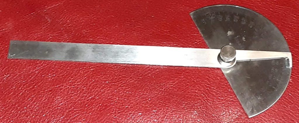

Gritomatic O Old Biker - Would the Goniometer work on the blades of a pair of scissors? that’s an edge where I think it would be very helpful
Thank you O Old Biker for going the extra mile in trying that out!The goniometer has a 0° mark in the center, dead ahead of the laser, and then graduations going out to 40° on either side. Here is the problem with scissors. One side of the blade has no bevel. That is 0° on the goniometer. The other side has a very large angled bevel. So I checked a couple pairs of scissors I had handy with a protractor. The first, a pair of KAI kitchen shears, had a primary angle of 25° and a secondary bevel with a 75° angle. The second, were a pair of Tandy leather shears. They just have a single angle of 65°. So you are trying to measure a bevel of 65° to 75°. Or maybe even more? With a tool that goes to 40°. So I tried pivoting the blade, of the Tandy shears, to the side until the reflection hit the 40° mark. At that point the reflection from the flat side of the blade was at about the 30° mark. For a total of 70°.
Further checking show that the scissor blades have different bevel angles on each blade. Rechecking with the protractor gave me 45° on one blade and 70° on the other. On multiple checks with the goniometer I was able to match those numbers. I quit testing the KAI shears because, the narrow secondary bevel, made checking with the protractor iffy at best, and the yellow nonstick coating on the blades made for poor light reflection in the goniometer.
My protractor.
So in summery, it looks like you can make the goniometer work on scissors well enough, to get as accurate of a measurement, as you can get with the protractor shown above. Who well that measurement will translate into setting up, whatever tool you plan to use to sharpen the scissors with; I have no idea.
