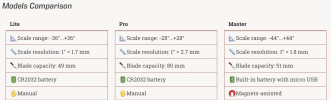

Only 1 available now is Pro, that was fast. But resolution ratio, degree / mm, is higher 0.37 instead of Lite's 0.59
I know that one difference between the Pro and the Lite is a 3" vs 2" blade width maximum, and I don't see the 2" capacity of the Lite as a problem for me.
I do not entirely understand what the difference in the "resolution ratio" means real world.
Can you explain?
Not really, other then finer grain resolution might prove useful for dental or surgical sharpening metrics. Gonna ask a buddy who practices dentistry but still cleans as well.
Maybe like measuring range of motion as a flexibility metric, a measure of fitness being different for various sports and competitive levels.

RE: "resolution ratio"
Assuming you are asking about the "Scale resolution" variance between models, I would assume it applicable like anything related to resolution. Larger resolution means easier to differentiate graduations on a scale.
Example Comparison:
Lite Scale Resolution: 1° = 1.7mm (1° of angle = 1.7mm on scale) Scale graduations are smaller, therefore harder to differentiate = decreased accuracy of measure.
Pro Scale Resolution: 1° = 2.7mm (1° of angle = 2.7mm on scale) Scale graduations are larger, therefore easier to differentiate = increased accuracy of measure.
The tube (where the printer scale resides) is larger in diameter on the Pro Version providing clearance for taller blade, and as a result the movement of the reflected laser is greater therefore easier to differentiate = increased accuracy.
Kind of the same principle to enlarging a photo of a yard stick makes it easier to read because the distance between the graduations is larger, except in this case the "yardstick" is printed inside the tube. Larger tube = larger scale.
resolution ratio called out at Gritomatic = scale range of 1 degree per scale resolution in mm for each type of tool... and Pro is in stock!:
Lite
📐Scale range: -36°...+36°
📏Scale resolution: 1° = 1.7 mm
🔪Blade capacity: 49 mm
🔋CR2032 battery
🖐Manual
Pro
📐Scale range: -28°...+28°
📏Scale resolution: 1° = 2.7 mm
🔪Blade capacity: 80 mm
🔋CR2032 battery
🖐Manual
Master
📐Scale range: -44°...+44°
📏Scale resolution: 1° = 1.8 mm
🔪Blade capacity: 51 mm
🔋Built-in battery with micro USB
🧲Magnets-assisted
