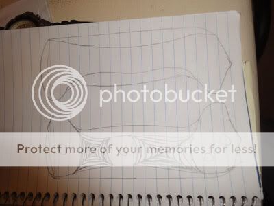

First step was to trace out the scales so that I would have a size reference and added lines for where they curved in for a 3D reference.

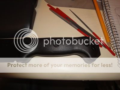

Next I transferred the pattern to the scales and started scratching it in with dental tools and the files. This gave a path for the Dremel bit to follow once I switched to it. Grivory is some tough stuff and it took quite a while to scratch through.

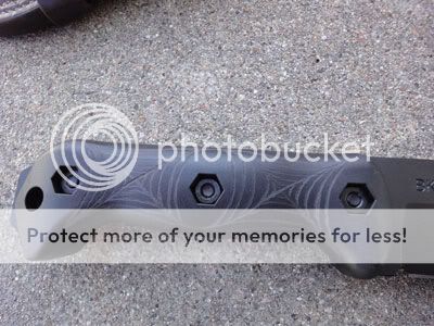

In this pic on the left side is just the pencil lines and on the right side I have begun scratching.
Here I have scratched and filed the lines in and they look pretty deep but they didn't add enough texture to add grip.
After doing the first side I switched to the Dremel and followed the lines and dug in a little deeper. I didn't want to go so deep that it created hot spots when using it. I think I have avoided that but I will have to see with use.

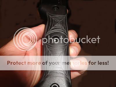

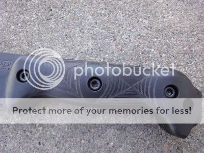

Below are the finished shots. The grinding bit I used on the Dremel was a little large and seemed to chip the Grivory. I didn't notice it while I was working but after washing it off it was apparent. Doesn't look as smooth or as finished but it does add a little more grip I think. Perhaps when I decide what to do with the BK-9 I can use something that bites more smoothly.

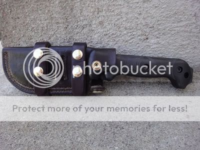

Knife with the sheath Nick made. Sheath Pron
