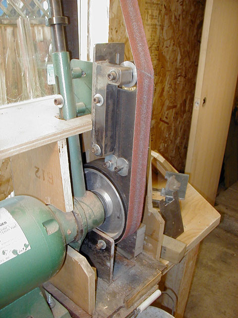

I got a good deal on a grizzly 2x72 new in box for $295.00 with 10" wheel. Since, can't afford anything else so, I'm doing my best tolerating the tracking issue. I tried spraying belt dressing on the 10" rubber wheel hoping that would keep the belt from swaying left or right upon grinding the steel but, to no avail. I do have the belt tension tight enough as much as possible. Both the top alum.wheel and the 10" wheel are equal in vertical position. Even tried new belts but, still the tracking knob and the belt are not working for me. Frustration and impatience and wanting to quit it all takes the best of me. I even tried electrical tape on the middle of top alum. wheel, nothing worked. I hope you gentlemen will help me fix this problem.:mad:Rey

i called reynaldo and found out he might not have enough of a hump in his drive wheel to keep the belt tracking straight. he is going to add some rubber bands to the drive wheel to make it high in the middle and try again.
I think it is because there is such a long span between the two wheels. The 3-4 wheel grinders would definately hold tracking better in that regard.

The drive wheel is the contact wheel. You don't want to add rubber bands to it. If the idler needs a crown, I'd do it with a bit of masking or electrical tape.
I think Richard may actually mean the drive wheel, which is also the contact wheel. I don't think Richard hollow-grinds and it wouldn't work if you did. Otherwise, it may help tracking a bit.
It's unclear to me whether you are trying to grind with the platen, contact wheel, or both when you're having problems. If the problem only occurs when using the platen, it's likely not a drive or idler wheel issue. Think about it like you're trying to fix a car.
I think he did add some tape to the idler wheel.
I'd observe the grinder, check the alignment of the two wheels in all directions- there may be some defect or oddness causing tracking issues. Such as the surfaces of the two wheels being "twisted" out of alignment, or the top wheel being left or right of the bottom wheel when viewed from the front. A long straightedge and a big square would help with this. Maybe look for unwanted play in the tracking mechanism.

i was thinking of another type of grinder and now that i see the picture i can see its the idler wheel that needs built up and that it is not the drive wheel.

A third wheel, just above the platen (like the pic I posted) would cure your tracking problems. The span between wheels is so long that the belt flexes.

I just went to the shop and put some electrical tape on the contact wheel build a center hump enough to hold the belt in place and it worked genlemen. I'm still going to check thorougly the vertical position of wheels and tubelar alingment also. But, for now thanks Richard and Brome and all of you for your help. God Bless. Rey
