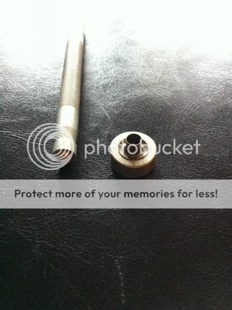

I had planned to buy a quality grommet setter, but I was at a knife show day before yesterday and they had some supplies. I bought a sheet of Kydex, the setter and anvil and 1/4" eyelets. Problem is they are just crushing and deforming in the setter.
Am I doing something wrong? I cross referenced the tool number to make sure it's the right size, but the tool just says "8095" and the websites say "8095-00" I suppose the "-00" is the critical part that tells the size... Can anyone look at their tool and tell me if I've got the right one?

That's the set up that I am using for kydex right now. 8095-00 is the right part number, but yours looks too big for some reason. It's hard to tell, but does the eyelet fit in the setter precisely?

Here's what mine looks like:
As for the hammer strikes, I use a ball pein hammer on my rail track anvil. Usually 6 medium strikes will set the eyelet well. Don't move your setter around, strike it at 90 degrees.

Thanks bud. Yup, looks like I was sold the wrong kit.
(not sure why my phone turned the pic sideways)
The setter fits just fine though.

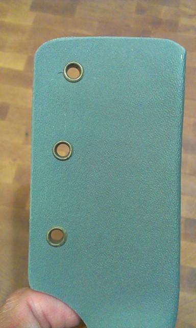

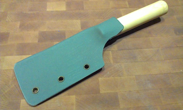

So I sat there kinda miserable. I don't like when my tools don't work for me. I got to looking at how the setter works and tried the anvil from my line 24 snap setter, it worked great.
The bottom grommet looks weird in the pic, but they are all good.

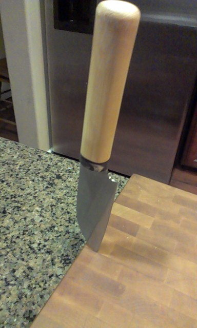

It's just a little sleeve for a nice little Santoku that I bought my wife at the same knife show.
