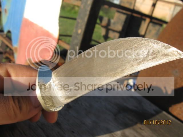

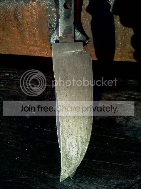

I grind my blades, not forging...yet.. I am making some knives out of my comfort zone to keep the fire in the belly burning and it seems to be working. I etched this blade with gun blue and bleach (Thanks Bruce Culberson). I have the guard ready and its nice and polished on the top side. I saw some guards from some of Aland's knives that were hammered/textured. I like the look. I am thinking of doing it for this knife. I don't want folks to think I am faking a forged knife. I just like the texturing of the guard and think it will look nice with the blade etch. And now my question. Do I need to heat up the guard to a certain temp before I take the ball peen to it, or can it be dinged up at room temp? Any tips will be appreciated.
This is the first hidden tang I am attempting. I will more than likely be keeping this one.

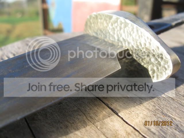

Go to a place like HF and get a 4 piece set of ball peen hammers. You want them from 3/8" ball to 3/4" for making different size dimples. Sand the ball smooth, and polish the ball each time you do a texturing.
Star with a circular looping pattern, sort of like scribbling. Use light strokes, as you can always make the dings deeper, but you can't raise them back up.
Once the entire area has been "sribbled" over, reverse the direction and start filling in the voids.
Don't just work one spot or it will come out uneven for sure.
Slowly close up all gaps and when it looks done, give it a light peening all over.
A brushing with a brass wire wheel, or a brass hand brush will finish it up in many cases.
Avoid using a power buffer and charged cloth wheels, as they can erase the high points in a split second.

I had the top part buffed out so I did the same to the ball peen I had laying around and this is the result. I ain't gonna lie but when I was banging on the guard with a hammer I felt an urge to find me and anvil and a forge. I think I am heading down an expensive path...... My wife is gonna kill me if I follow through with it.
As you also have discovered, this is a good way to close up a bad fitting guard slot.
