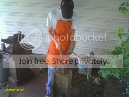

Shaping the blade profile...
Learning the arcane ways of the whompin stick....

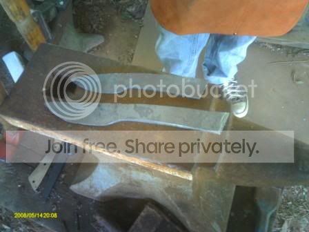

His blade is the bottom one, pretty close to final shape but he's about to learn why you don't leave hammer marks and forge clean.....

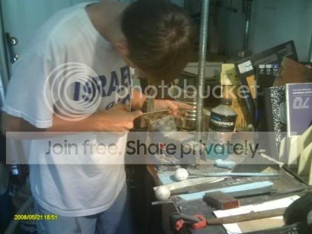

If he wussed out drawfiling I wouldn't bother with a thread... since he did 4 hours of drawfiling with temperatures in the 80s and 80% humidity I'm pretty sure he can finish the blade out.
Here he is learning exactly what I meant when I told him that he can either hammer cleaner now or pay later... He's regretting not hammering a bit longer. Drawfiling the tang.

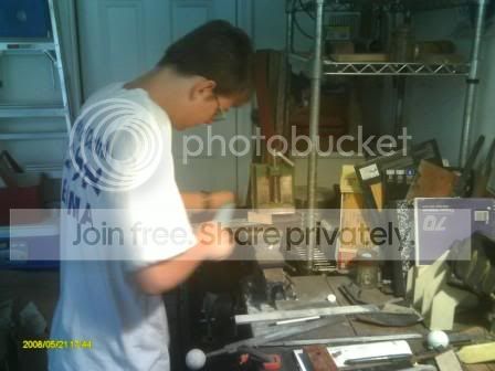

Cleaning up the profile....

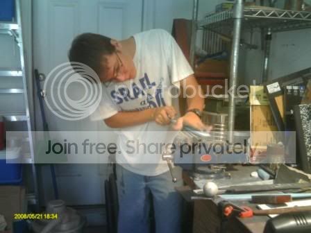

Filing in the plunge cuts....

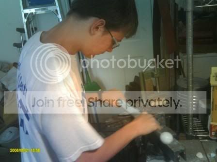

Drawfiling the blade.
Sent him home with gear to do his "homework" sanding fixtures, files, a copy of my sanding block and sand paper to get the blade to 120x finish.

I like the idea of using golf balls for file handles. Did you just drill them and pound them in?
Yes, I drill the hole slightly undersized then pound them..... wear safety glasses when drilling, I didn't know that some golf balls have a liquid center. I use golf balls for just about anything in my shop that has a pointy part that I don't want to contact. My sanding bar has tapered ends and I use golf balls on those for handles also. I get them at the local flea market for $3 for 15.
