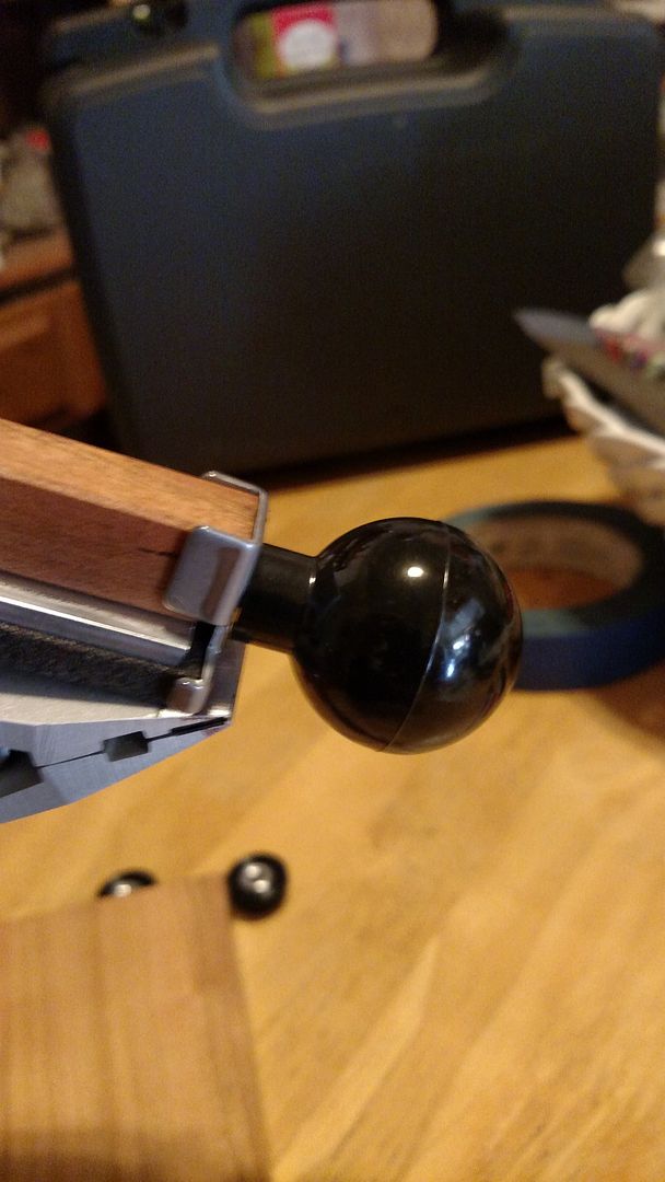

Something to consider with the KME is the ability to change out the knobs for ones that are larger and easier for you to handle. I swapped my angle knob and stone holder knob for these:
I can't remember the thread sizes but I'm sure the KME guys will tell ya.

It does seem that the KME is the way to go so far. I like the idea of adding larger knobs too.
