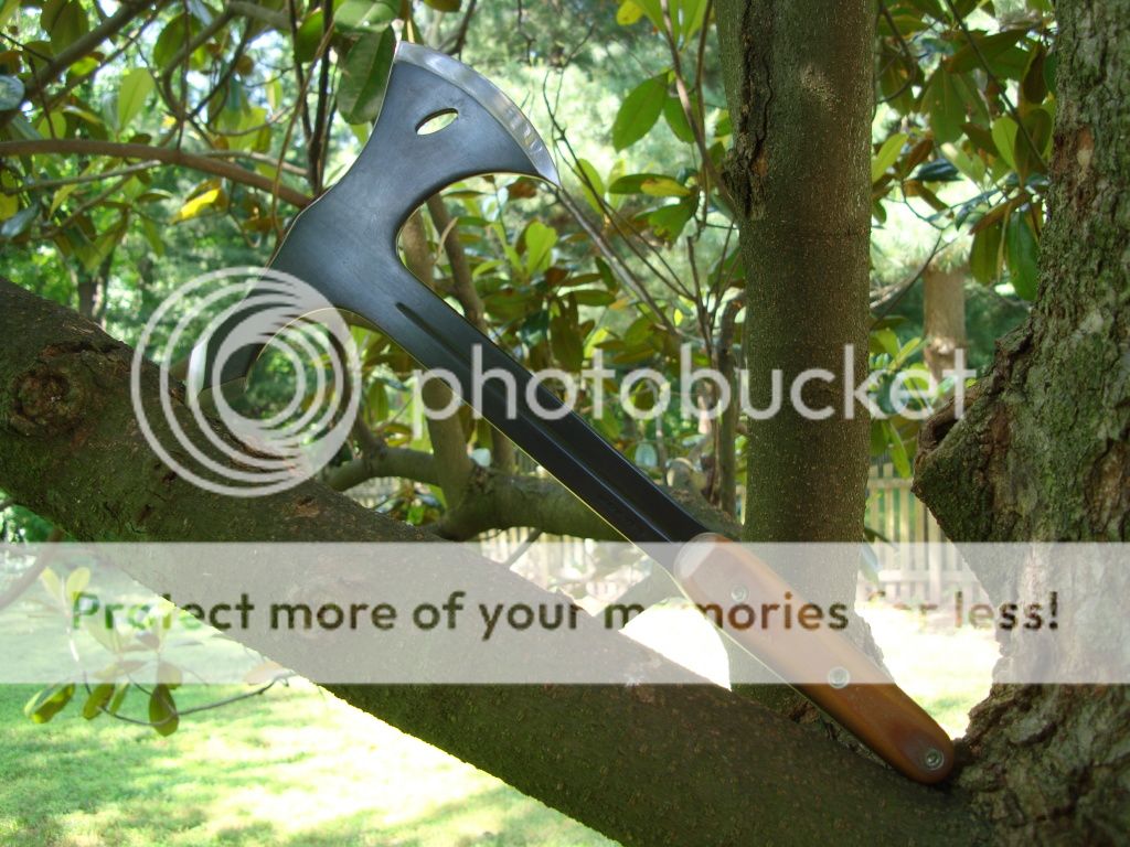

Thanks for the info! Gun blue, at least the cold variety, seems like it would wear off easily, as even a slight touch from fine sandpaper leaves a scratch. I just used it on a Condor throwing axe that I stripped, and I'm pretty sure it would require a touch up after some chopping. I want to try working with Duracoat next.

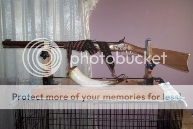

Here is a muzzle loader that is suppose to be a copy of a St. Lewis Hawken, (it is not a 100% accurate to the real Hawken rifle). It has had a browning process done on it with Birchwood Casey Plumb brown. This was done by a hot process or applied after the metal was heated.

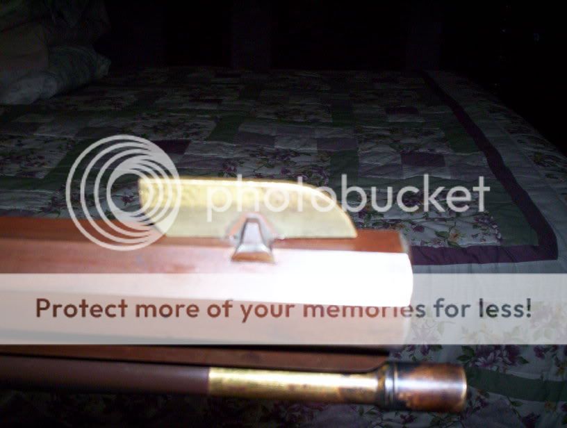

Here is a close up of the barrel.
Browning is a done either by a chemical or can be done by indirect moisture/humidy. There are a couple of chemicals for inducing the browning, one uses heat to accomplish the browning and the other is done cold. Once the piece is rusted brown the heavy ugly stuff is removed by a process called carding. The major stuff is removed by polishing and the minor stuff become a light coat of rust or brown.
Bowning is pretty much like Blueing in that there is a cold process and a hot process for Blueing.
Both processes require the metal to be clean before starting to get good even results!

These pix are my axe before using it for any chopping. I'm a bit short on wood for chopping right now but I want to post some pix when I do find some branches that need to be cut up. THen I'll see how well this bluing job holds up.
