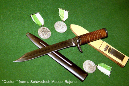

I did it with the blade of a swedish Mauser 96 bayonet 25 Y ago,
and it still looks good. (the bowie tip was a tuning made by a friend)
Dont know the exact steel but it gets sharp and stays so.
It worked much better when the steel was warm, (not hot, i could touch it).
I remember it was a white tube with blue sign, "Gun blue" ..
Sorry not a detailed pic of the blade,
Oh - and it stoped rust!
Bigbore, that is a beautifully done Mauser. Only thing i would do differently is make the blade a tad shorter, but thats a personal preference thing.

Thanks a lot,
(you should see what i did with the rifle, M96, 6,5x55 ;) )
i was young then and now my flavor changed to shorter blades too,
but please remember: that was the 70`th, with the survival-knife-silliness, and having not enough money for a "real" Rambo knife,
i tried to copy one.
The grip of the bayonet already was hollow and the endcap simply is a big screw.
I wraped the grip with leather (glued on) instead of nylon (Rambo vorgive me please) and made a SOB IWB leather sheat by simply glue some leather parts together, holds till now!
Please recognise the original metal sheat was customized (made one hole + removed some parts) for tip down carry under a parka.
