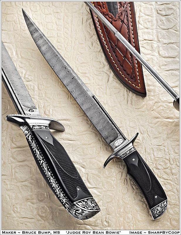

A class in gun checkering is about a month away and I was thinking about taking the class so I could checker knife handles. But am concerned that it might not be a welcome feature on a knife. Checkering micarta might be interesting but the handle area is so narrow, I don't know if it would be interesting.
Anyway, I would appreciate your thoughts on it. The class is offered in Kalispell MT July starting 17th for 5 days.

How's this for "interesting"
Checkering handles is not generally done with a checkering file. It is done with checkering tools that are used to checker gun stocks. Checkered handles are pretty rare, but are something you could use to distinguish your work from others. I think you could also checker handles for other makers, if you were so inclined.
I have a checkering set and have played around with it. I actualy have a knife in the making that I want to checker.
I love the look. A very basic handle can be done with a checkering file, but a more shaped handle will need checkering tools.
The basics aren´t that hard but I think you´ll need lots of practise to realy master it.

Checkering that is well done looks great on a knife.
It is pretty much relegated to safe queens and high end collectables since it wears on a user. Layout and cuts have to be very well done since there is such a small canvas to work on. Any bad lines/angles/cuts/etc. will stick out horribly.
You can order all the tools for checking from Brownell's. I'd recommend getting the fancy set if I were you. I bought the more basic one, and it's kind of a pain to change out the bits, also consider getting some very fine "v" chisels, you'll need them for finishing corners and such. Be prepared for you first efforts to look like crap... I know mine do! it's a serious art form to master, especially if you are planning any crazy curves!

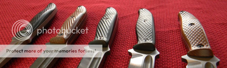

This isn't checkering, but it's a similar concept:
10.jpg~original
It's durable and feels good in the hand. It's done by machining the scales with a ball endmill and tweaking the angles and step over to create a diamond pattern. This approach is becoming more common and more popular as folks are starting to use CNC more in their process.

I'm a fan of those Nathan I think they would be good on gutting knives as I'm a hunter and need all the grip I can when elbow deep in a whitetail:)
