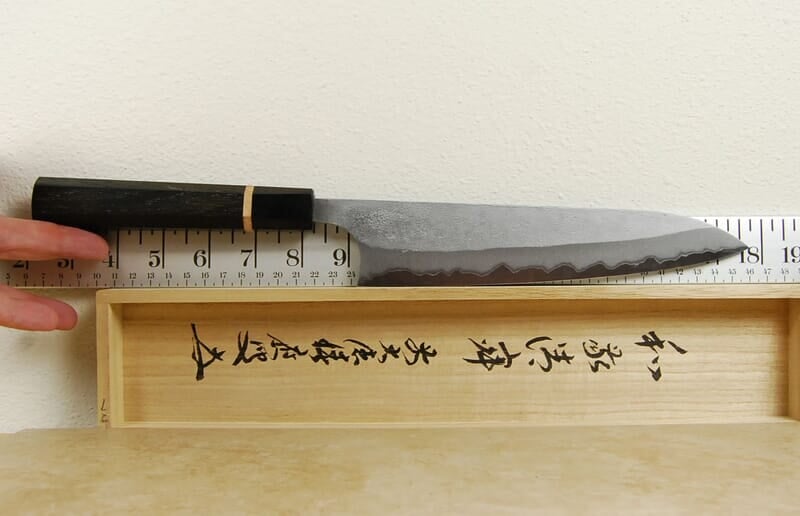

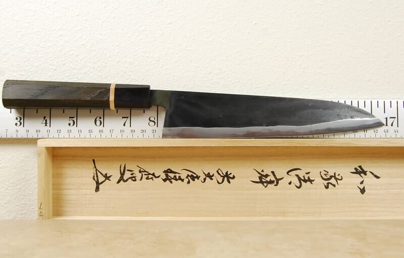

I will respectfully disagree and say that the ones I own have a very slight angle between the handle and edge. It is very slight, but it is real. Go to chefknivestogo.com and you can see for yourself. All the pics below are from that retailer. I didn't cherry pick, but picked famous knives/bladesmiths.
Itsuo Doi:
Konosuke Fujiyama:

As mentioned above and from looking at the pics I posted, you can see that handles that are in line or neutral to the spine when the cutting edge heel is slightly angled to it (instead of parallel to the spine) are very slightly raised. This can help give finger clearance from the cutting board while at the same time giving a pleasant visual look because the line is straight from the spine through the handle. Look at the very first knife, the Itsuo Doi and notice the handle install was at a slight angle upwards, and that's why it looks a little off compared to many of the other knives. Depending on use, sometimes knives that have the handle slightly angled downwards can be useful, also some drop towards the butt of the handle aid in your grip in cases, so you may see these carry over into kitchen knives. There are some times when slightly angled upwards can work too tho.
