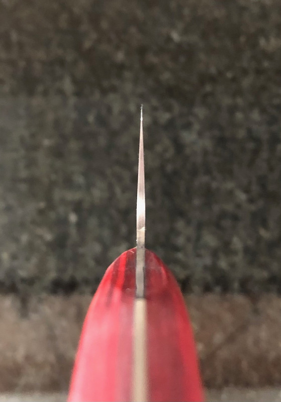

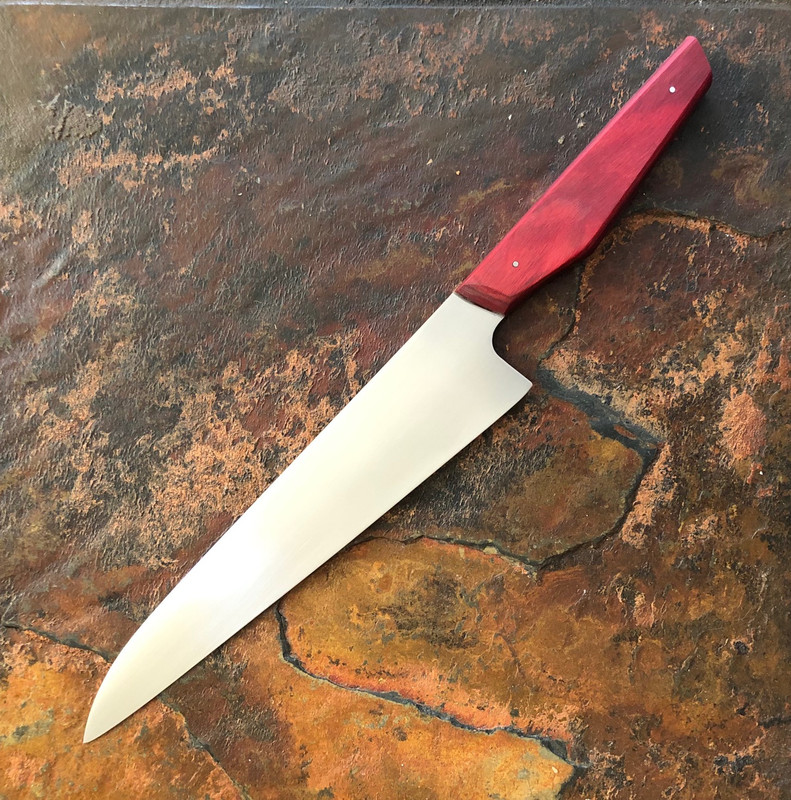

Here is a 210 mm Gyuto style I just finished over the weekend. The blade was sitting around for a while now, so I thought I would finish the handle and see how it looks.
I tried a different handle profile, than the authentic Wa style, just for fun. Thickest part of the spine is at 0.08".
What do you think?
All comments are welcomed!
There is some dust right on the edge, but you get the idea of the grind.

Nice job. The profile, grind, and handle should make it nicely functional.
I think attention to a few very minor details would take it to the next level.
In your second photo, you can see the underside of the profile wasn't cleaned up and there are a couple epoxy streaks.
You could carefully sand from the spine, all around the handle to make it bright and smooth.
I also suggest shaping the front of the handle pieces while pinned together, before attaching to the blade.
Especially if you have a disc grinder, you can get them smooth and symmetrical.
A bit of tedious work to get the front of the handles to the same finish you will do on the rest of the handle after glue up will pay off.
(I have a few kitchen knives I made 15 years ago still in use and I see these same issues every day...).
The cutting edge profile looks to be a little too flat....I’ve made flatter profiles but yours looks a little too flat. However it Could be the angle of the picture
handle looks like it could benefit from some rounding and contouring for comfort
Great, thank you for your feedback. I agree with your comments. I admit, I rushed it a bit just to get it done.
I agree, my feel as well is that I went a little too flat on the edge profile. Right on with your assessment, good to hear it from someone else, thank you!

Just as a comment, I was not happy with the edge being too flat, so I pretty much considered the blade a failure from the beginning, however I wanted to see how the handle/scales look on this design. Not an excuse, but just wanted to mention it. I always try to finish things to the best of my abilities, but I have a hard time putting the effort in something that I don’t consider to be worthy.
Anyway, you brought up a very good point, thanks.

Regrind the edge profile shortening the heel Height
Or take the tip up higher
Yes, I’m working on a new profile version with more belly, the heel height is already too short as it is. Could do the tip grind, but I rather go for a new enhanced version, keeping the intended blade length.
Thanks again, I appreciate your feedback,
