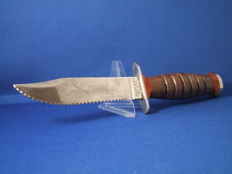

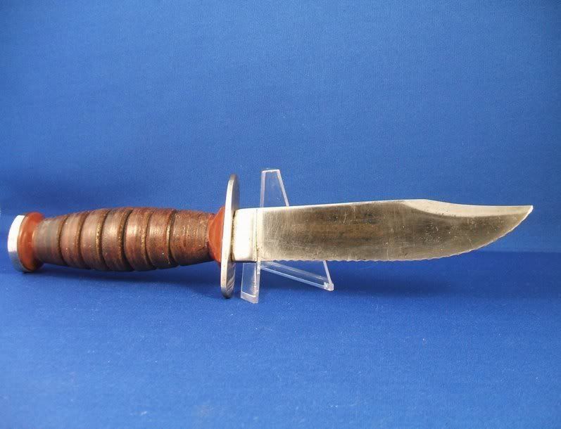

The above knife is a commercial copy of a real military pattern.
First adopted on 16 October 1953 as the MIL-K-8662 (AER) Pilot Survival Knife this Schrade design was the issue flight knife until 1957 when the military adopted the now familiar Jet Pilots Knife as designed by Marbles but generally supplied in bulk back then by Camillus. The original guard was straight but later altered to the M3 configuration and the sheath was clipped on the corner to allow it to fit tight. The oak leaf sheath was also a military item believe it or not but the issue one had rivets around the perimeter in case the stitching broke. I have some photos of guys wearing them with the embossed finish. It is NOT in the specifications but they did make it into the inventory. In the 1954 test when it was pitted against the Randall Model 14 it again won the test. Only due to the cost but it did indeed beat up a Randall as a military issue knife. In that test they again show the oak leaf sheath in testing!

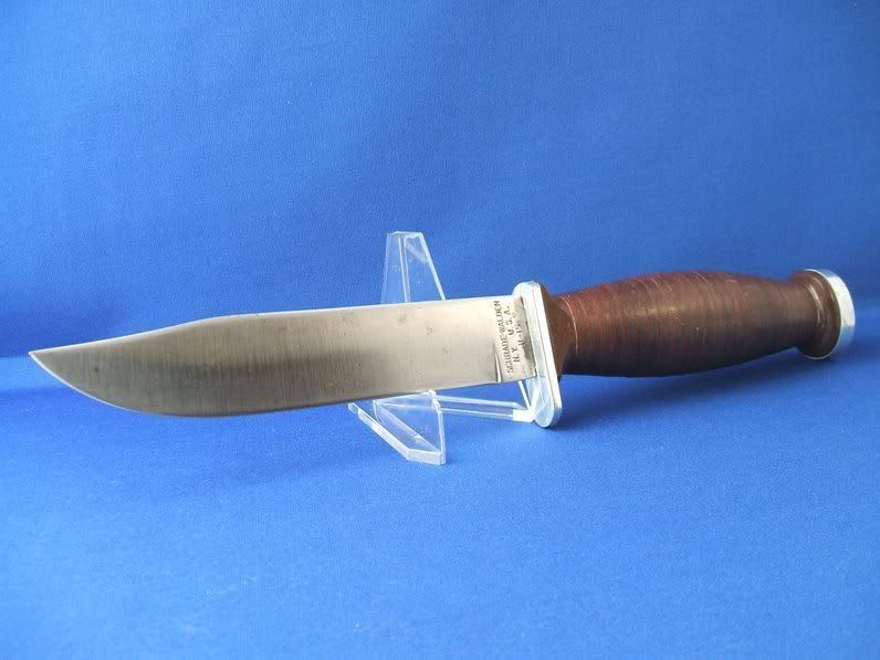

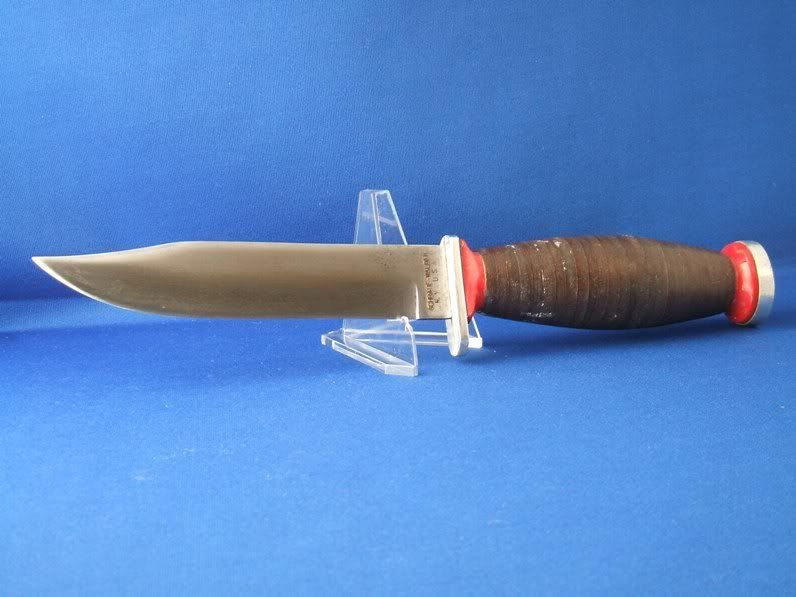

The leather washer handles on the original M3 are distinctly different in appearance due to the way the handles were assembled. In the beginning... the handles were made by stacking large and smaller washers to form the grooves. Some time in 1943 to 1945 most if not all of the cutlery companies converted over to a machine made handle. All washers were of the same size and then a machine called a Hafting machine (almost like a lathe) cut the grooves into the handles. Look closely at the above handle and you can see the grooves are Vee shaped not squared off like the early M3 handles. Imperial seems to have changed over in 1944 when they were making the M4 bayonet as all M3's I have seen are square grooved from this company. Numbers of grooves were specified in the specs but loosely followed, I have seen 6, 7 and the typical 8 groove handles on M3's. The grooves were dropped to 6 on the M4 bayonet so this handle generally follows the later pattern handle. Also 6 grooves were called for in the Pilot survival specification and as this piece is a direct copy of it I would GUESS the same tooling was used. I hate using that word but it seems to fit here.
Schrade won a bid in 1956 on 23,787 of this pattern knives for the Navy. The cost with sheath was ... $1.196 each, oh for those days again.
