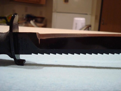

Hi all,
New to knives and this forum, I recently purchased a glock 81, which came very dull, I took it to a local "professional" to get it sharpened, attached is what I got back, he took alot of steel off, in my opinion. the knife is sharper but i don't think he did a good job at all. I measured and there is about 1/16 of an inch of steel missing through out the length of the blade. What do you all think of the of the quality of the sharpening service? Am I out of line thinking this is a "hack" job? Also, is the knife as pictured a convex grind?
Thanks

That's way too thin for a rough use fixed blade. It looks to be 10-15degrees per side

Yes that is a bad job, and I suspect there is an appropriate angle on the edge because the grind looks convex, making a lot of shiny steel on the sides, but a higher edge angle. You are right in saying that there was a lot of metal removed. How sharp did it come? Also the grind is sloppy, so yea, sorry but it was a bad job.
thanks for the response flyingkiwi, the knife was dull to the touch when I got it, i accidently swiped my hand along the "sharp" part of the blade when I opened the package, luckily it was so dull, i didn't get cut. the sharpened knife is better but still not what i consider sharp, i see people on the internet cut the hair on their arms with a newly sharpened knife, mine just pushes my hair away for the most part. Is the Spyderco Sharpmaker good for beginners, it has to be better than what was done to my knife, right? - thanks in advance FlyingKiwi.

I will reserve comment...the first image looks really bad, but the last images in that set look a bit cleaner.
Regardless, you procured a service that you are not happy with the results (apparently). Your satisfaction is all that matters.
Regarding what I think of the quality of service? It has everything to do with the instructions given, and the desired results. The bevel looks huge and coarse, but what is the actual inclusive angle of the bevel? Is the burr removed? How does the knife perform? And what did it look like prior to the services?
Not trying to be a jerk...I just see a LOT of difference between this:
and this:
could be the lighting?

I'd guess that whatever looks worst, is. Lighting doesn't turn bad sharpening good; just hides the worst bits.

nothing you asked is offensive to me, don't worry. The two pictures you see are the same knife, one had the flash on the camera go off. I am new to knives (other than the kitchen kind) I wanted an all purpose type of knife for outdoor and utility use. I just went in to the shop and wanted the knife sharpened since it was really dull when I purchased it. The knife is sharper but not as sharp as I've seen demonstrated online. I do not know what a burr is, but if you explain that and how I calculate the inclusive angle, I can let you know. The knife's edge was equal to the tang or hilt (i do not know if those are the right terms - the part above the handle before the grind starts) so the knife is thinner now, does that decrease the strength? I wanted to do some yard work with it, now I'm worried it will break after a couple whacks on small branches and the like. Also, how did you insert the pics in your post, I tried but couldn't get it to show, that is why I used a flickr link. The knife was new, if I could figure out how to add a pic to my post I will try to find a picture of a new glock 81 online, if you want to see what it looked like sooner, a google search will populate a good number of images for you.

I think that the sharpening job is far from a professional job, not to mention charging 39 bucks for that.
Having said that, that knife is still usable and will perform the job it was designed to do.

I won't argue with you on that...but that first image near the left side of the image there are what appears to me to be dust or rag particles stuck in an oil coating on the side of the bevel. I have seen this many times in images I take...I wipe the oiled blade down for the image and snap a few...go to post processing and the edge looks like it was put on with a broken cinder block.
Another thing...if you test an edge with your thumb, then look at it with the right lighting, the edge will sometimes appear chipped and damaged when really it is perhaps skin cells and schmutz from your finger tips clinging to the edge.
I am not suggesting that the job is great...but perhaps an image can make it look worse than it is? Ask any professional photographer...they will tell you that a bad image can in fact make a BEAUTIFUL knife look like hell. I am not suggesting at all that this knife is a pristine example though;)

Looks pretty bad, he took his sweet time on the plunge. The bevel near the ricasso looks like a much lower angle because he started there and put more time and pressure into that area. I've sharpened for a couple people before, but never charged. I've recently gotten into sharpening knives for some dudes on youtube. Here is a video of one I did for a guy:
