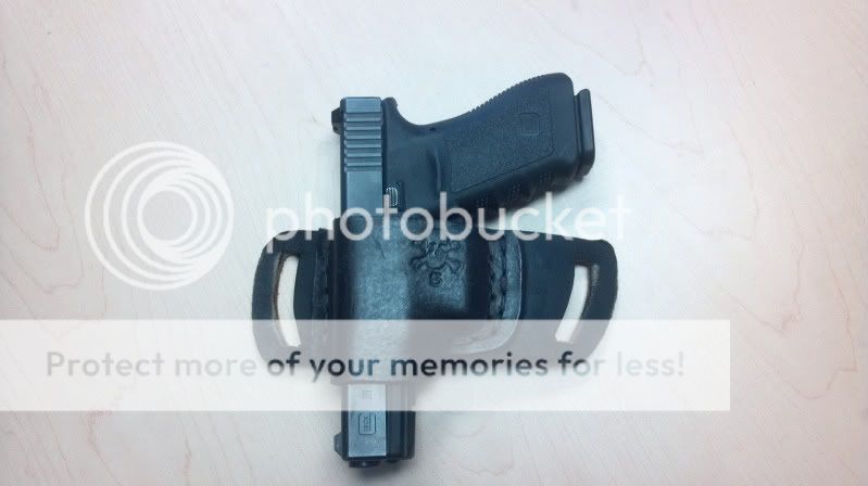

Here's my EDC OWB knock around holster for my Glock 21. I like to carry a beast like this straight up and down since it's hard enough to keep it from printing anyway:D What you can't see from the back is that the belt look behind the gun is positioned in such a way that I can slide the gun around to 9 o'clock (like if I'm out walking about in the woods) or slide it back to about 7:30 if I want to hide it a bit more when I'm out and about in the city. It's been designed around my brand of jean's belt loop spacing:p
The leather and dye are from Tandy. One thing I have started to do is hot smoke my holsters after I set them wet. The smoke and controlled heat causes the leather to set up brick-hard. Perfect for a form fitted but fast drawing holster like you would want on a single action cowboy revolver. Works OK for the Glock holster too, I guess:)
