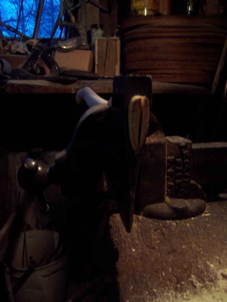

Hello all,
So, instead of obsessing over knives I don't really need and spending money I shouldn't really be spending, I picked up a nice old Collins Legitimus CT pattern (thank you Double Ott!) as a project to keep me busy.
After lots of effort I got the old haft removed, and then I ordered a new straight octagonal one from House Handle, which shipped it very quickly. However, I got one a lot shorter than I thought. I measured the original haft and it was 28inches from shaft to end, and so I ordered a 28 inch one from House Handle...however, it's 28 inches overall. I guess I mis-read.
Is this too short to hang the 3.5 pound CT head on? If it is no big deal, but if that length will work fine I'll continue on with the process.
Also, when rasping it down to fit it in the eye, I remove wood evenly (and slowly, checking fit often) from all around eye piece correct?
Thank you
Collin

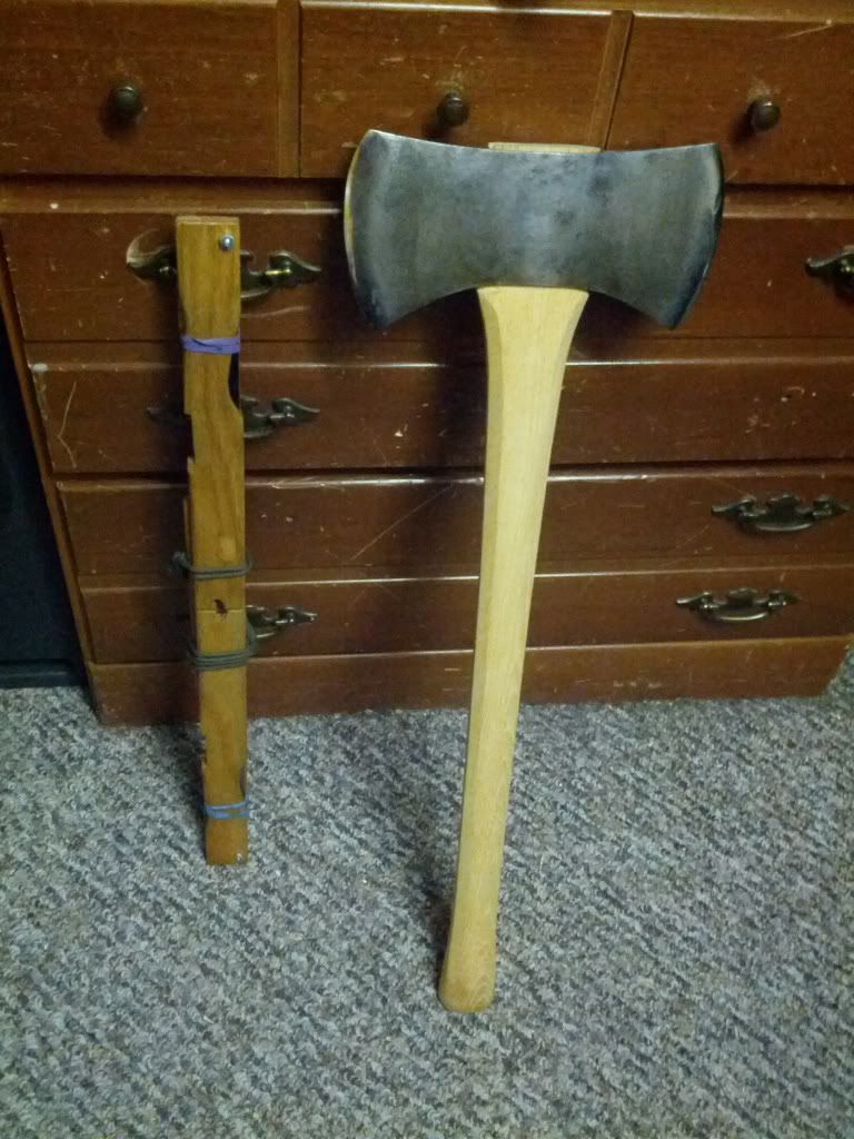

It's much of a personal preference and maybe a safety issue depending on how skilled an axe-handler you are. In general, the longer the handle, the safer the axe will be. For general splitting work, with a full sized axe head - 3.5#s or so, I would go with at a 32-36" handle. I think you'll find you'll be better off with a 36" handle with the Connecticut. You are going to have to do a lot of work to seat the axe lower on the handle (very close to the shoulder) in order to fit that wide CT axe eye.
rasp, trim, spoke-shave off material on the handle to fit. High spots will show up darker when you remove the head. Use an old handle or piece of wood to knock the axe off. Kerf (cut) in the middle should be open. Once trimmed, the axe head should slide on pretty easily. Seat it completely with knocks on the end of the handle. Check out an axe to grind for a good instructional.
Personal preference, and what you are going to use it for. As a swinger of many axes and pulaskis, personally I would like to see a 36 on a full sized CT, but I'm fairly tall. Some shorter people like a shorter handle. You run a risk of short -arming a swing and having the head come around at your legs with too short of a handle IMHO. But for limbing. A shorter handle might be more manageable.
As of right now, I have my 3.5ers on 32" hafts. More like 30.5-31" though since you tend to lose 1-2 inches when you cut off excess during hanging. They feel ideal to me. At 5'4", I can't stand the feel of a 3.5 on a 36".. It's alright for splitting, but makes every other task just feel inaccurate, cumbersome and needleslly tiring.
That said, I have some 28" and 30" hafts on the way and will be trying those out. Really wanting to see how a 3.5 jersey feels on a straight octagon 28"...
Thank you all for your input. I've been thinking about it all day, and after playing with my Hudson Bay which is on a 28inch haft and about 2 pounds, I don't think I want 3.5 lbs on a 28inch haft.
I'm torn as to what to do now though as I want a straight octagonal handle, and I can't find one in 32inches, which is the length I want for this axe. It was the original length after all...well minus the inch or so that was lost in hafting as killa_concept mentioned.
Why not try partially fitting the head on once you get it and checking before you make the call? Actually rasp it down and get the head on minus the wedge and handle it a bit. I also have a GB Scandi forest axe (2lb on 25") as well as a Hults Bruk military axe (2.5lb on 28") and while both feel fine - with the former feeling a tad light - I don't feel a 3.5lb would be too terrible on a 28". Then again, I'm 5'4" and in half decent shape.. A taller individual might find it awkward and a less fit individual might find it too heavy so YMMV. Keep in mind that the racing axes used in competitions are 5-7lbs and hung on 28" (sometimes 32") handles.
If you're dead set on a 32" straight octagon pattern then I'd suggest just ordering a straight 32" from hickory handle store and doing the octagonizing yourself. With a good quality 12" rasp, I was able to octagonize the 28" haft for my 3.5lb GB double bit in around 30 minutes. Could probably do it in around 10 with a belt sander but I don't have one at my disposal and the work was actually enjoyable. Makes the tool that much more mine and it came out quite decently if I do say so myself:
Oh and that is a 3.5lb hung on a 28". It is a DB and better balanced than a SB, but still more or less the same. Feels fine to me though and is enough for me to want to try hanging this 3.5lb Jersey Pattern Keen Kutter on a 28" straight octagon. I'll let you know how that goes :thumbup:

Thank you all again for your thoughts. I really did consider putting it on the 28inch haft. I went and swung my Hudson Bay that is that length for a while, and I really feel I wouldn't want more weight on the end of it. The CT also came with a 32inch haft originally, and I messed around with it a bit (took a few chops with it) removing it, and I really liked that length. I want something with more reach in this one.
I did call House Handle and for straight all they offer is 28 or 36...they didn't offer any custom lengths to me. I will keep Hickory Handle Store in mind for the future. For now a blacksmith I've worked with in the past (the one who made my Hudson Bay) is going to make my haft for me.
