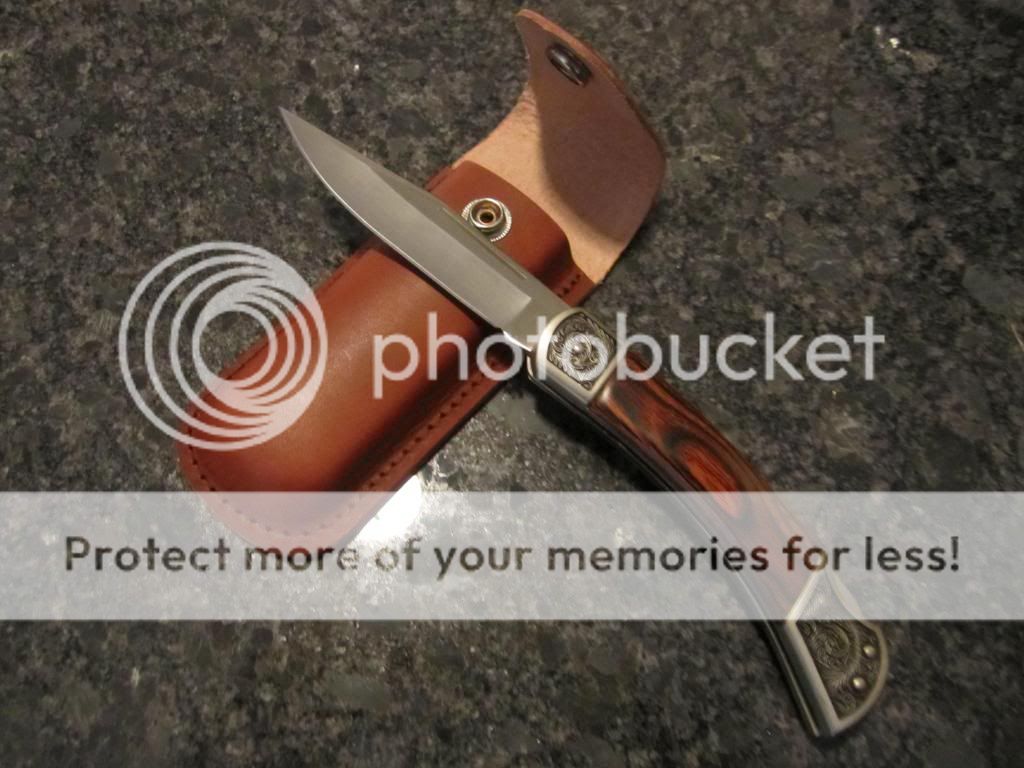

So I have been carrying this Maestro Wu BO1 for a couple weeks now. Really happy with the F&F , I gave it a 1200 Atoma Edge just for carrying around. Over the past two days I've been tinkering with it , taking it well beyond that (currently its sitting at 160,000 grit..)
As she came
And now...
Fun stuff!

Microscope , once your beyond light microscopy it gets challenging. Whittling hair on one side and not the other is a good indicator. But at this level of refinement you don't work one side too much and raise a burr in the first place. Alternating strokes with as little weight as possible are the key.

Well , with some practic you should be able to scrape off some armhair , even with something as coarse as the Atoma 140. The secret is to use light pressure and abrade the burr in place without flipflopping it over and over.
Use extremely light edge leading strokes on the burr side until you feel it abraded off , feedback will change. Then swap to alternating single pass edge leading strokes (again extremely light pressure , the blade should barely be touching the stone here) , and watch what happens after a few of those :)
