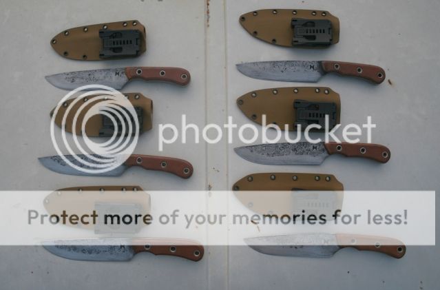

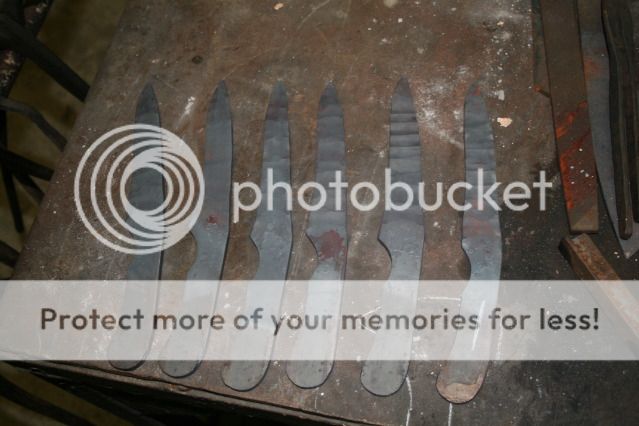

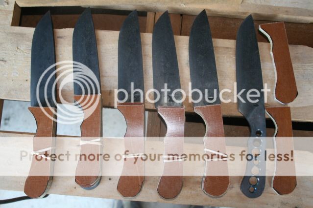

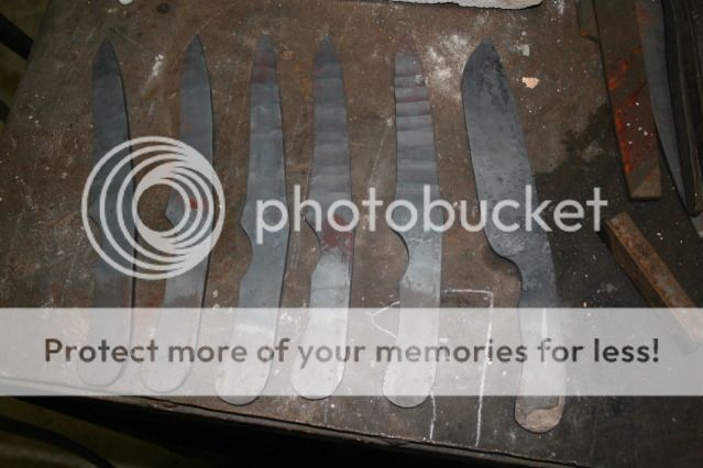

These are in the hands of some Marines that are training for a deployment next year in Afghanistan. For the knives I contributed, they were forged from 1 1/2" x 1/4" 5160 with natrual canvas Micarta and flared stainless steel rivets. The blades are around 6" long (forgot to measure them before I packed them up) and are stout. After heat treatment and fitting the handles, I slammed several of their points into an old clothes dryer (no, they aren't what tore up the dryer so badly in the pics I last posted) and they stayed solidly in the hand and were undamaged while penetrating the sheet steel.

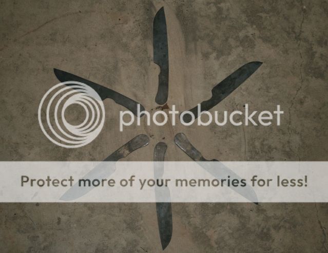

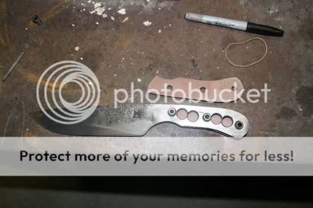

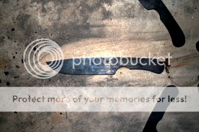

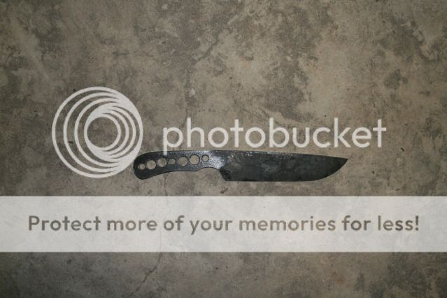

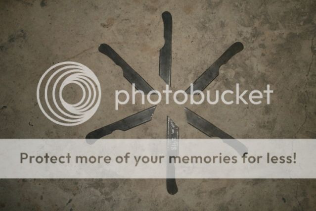

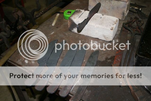

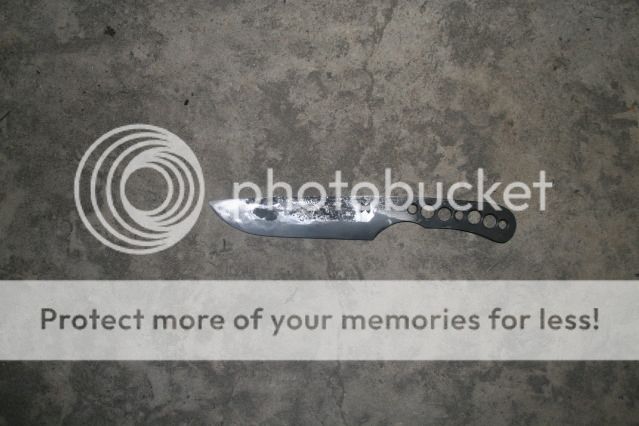

This is what they started out as:

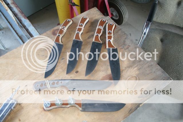

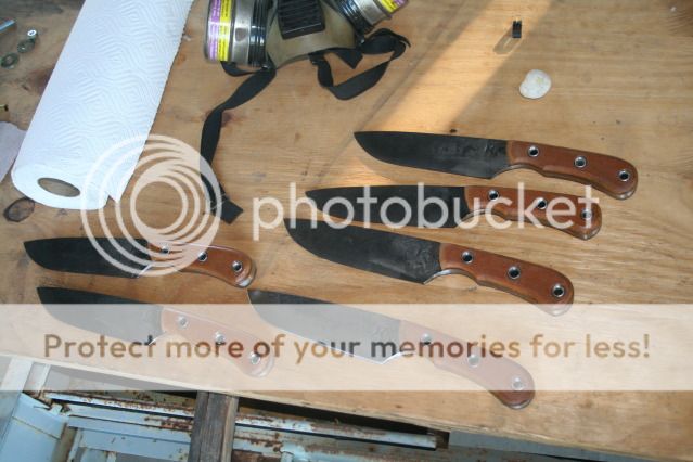

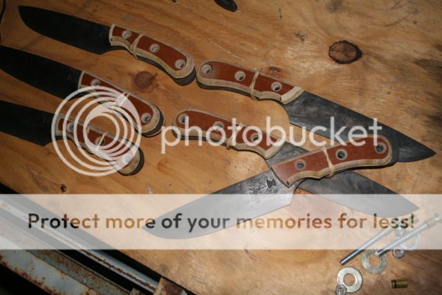

This is what they ended up as:

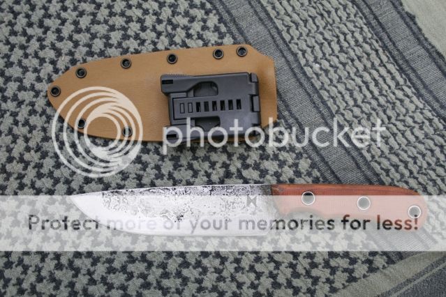

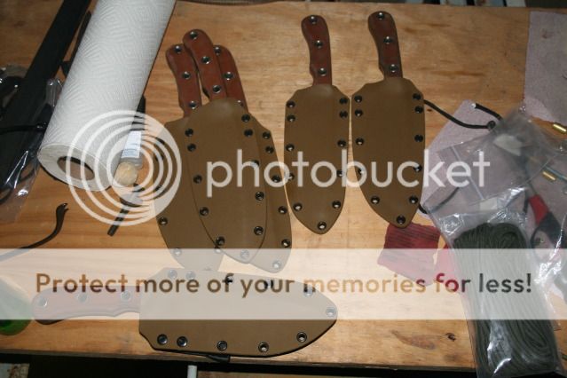

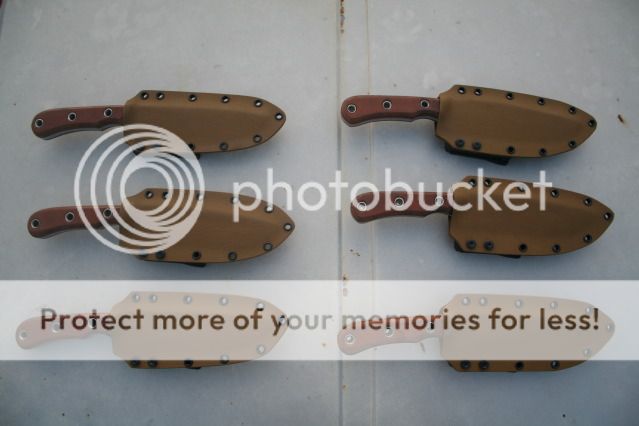

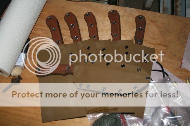

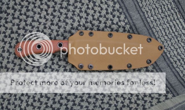

The sheaths are coyote brown Kydex with TekLoks. I made them where they'll shake upside down pretty vigorously without moving, yet will pop out easily when pulled.
There's a little bit of variation, mostly in the angle between the blades and the handles, but they're pretty close to each other. All of them shave hair.

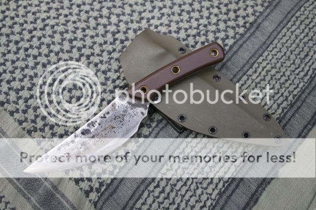

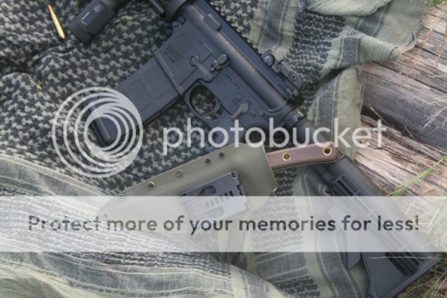

Tobin made his from 1084. He usually works in bone, antler, and wood for handles and leather for sheaths, so this was his first go at Micarta and Kydex. I helped him some on them.
He went with olive drab with brass flared tube rivets.

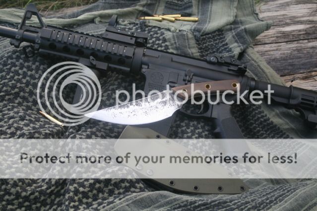

We took some pictures when it was mostly done with his buddy's AR as a prop.
Tobin looking like Subotai:
And after final tweaking and sharpening to slice newspaper right nicely:
