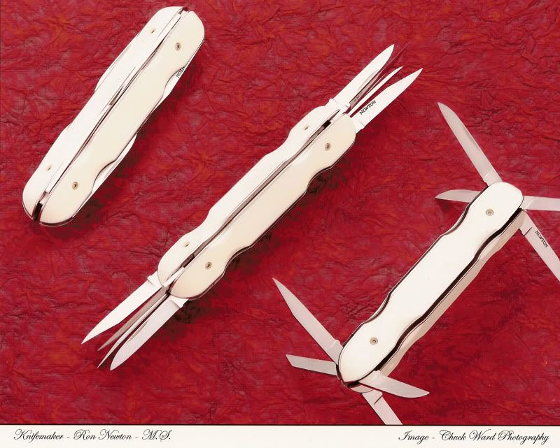

That's a "barrel" knife also -- there are blades out the butt on *four sides*. You can imagine the complication this brings to the spring construction, on top of everything else. Though there is one saving grace -- other than making sure each blade has a proper walk and talk, you don't have to worry about making sure any of the springs are flush with anything, since all the springs are in the center of the body of a barrel knife, and you cannot tell their precise position so easily (plus most larger barrel knives have endcaps of a sort to cover the open ends and thus mostly hide the spring ends).
Here is just an 8 blade example by Ron Newton to put it into perspective:

The exhibition year knife and the above knife are both "quadrangular knives." 365 is not a multiple of 8, but 368 is.
This is a barrel knife.
Sorry - but the exhibition knife and the Newton above *are* barrel knives -- that's what these types of knives have been called a long time. Yes, I know about the other type of "barrel" knife - a far more recent arrival on the scene than the Sheffield barrel knives. As reference, I point to "Sheffield Exhibition Knives" pages 71, 205, and 238-239, as well as "Exhibition Knives - Joseph Rodgers & Sons - The Samuel Setian Collection" pages 226-227 -- all knives of this type are called "barrel knives" in these books. While he's a great reference, it's sometimes harmful to treat whatever BRL says as unquestionable Word of God -- while I don't know what the original Sheffield cutlers called this style of knife, I feel quite certain that they never called them "quadrangular pen knives" - that's a BRL-ism.
