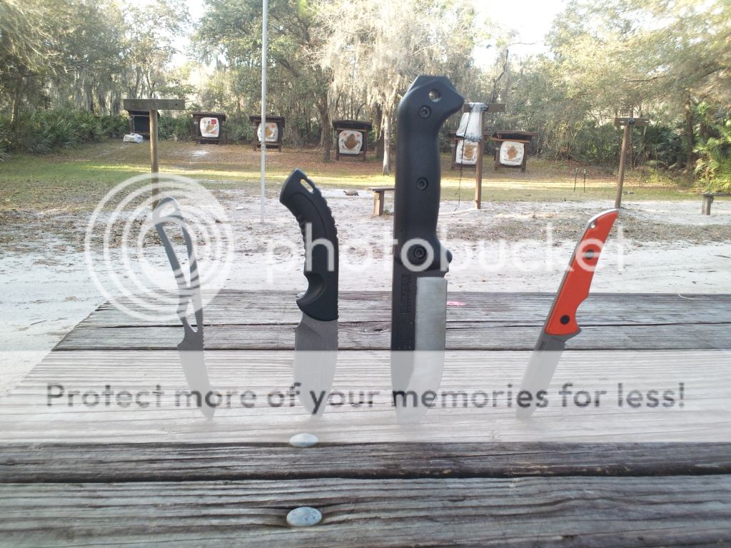

Sanding is the only way. Stripper not only works under tape but creeps into the coating itself sideways if you will. You will end up with a very ragged looking edge because you'll get pencil eraser sized chunks of finish that have come loose next to areas that stayed put. You will end up stripping it all off. I know, I went there with an ESEE-5. She's naked as a jay bird now and I was just going to do the main bevel.
Sanding will give you much more control. Masking tape will work pretty well although don't try to rely on the same piece for the whole sanding job. When it starts to get a little frayed, peel it off and put down fresh. You'll only have to do that once or twice a side I'd think.
Actually. I forgot to mention that the flats on beckers are very dark grey when stripped and the bevels are nice silvery color. May be close enough to black coating for you
