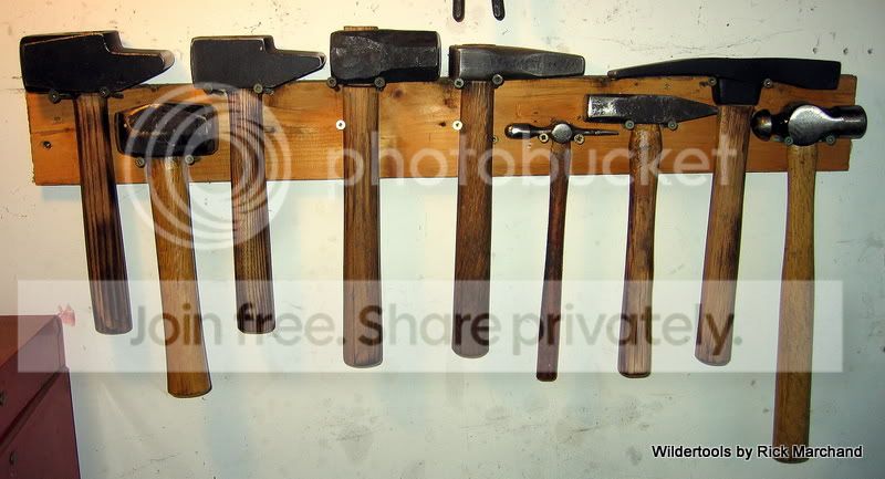

Here are my collection of hammers.... each has its own job...
and my two most frequently used metal movers...

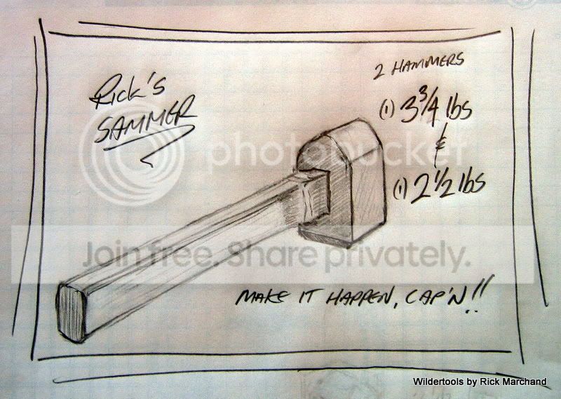

Sam is SUPPOSED to be making me a hammer or two..... If he ever makes good on that promise, I will gladly "surrender" the Frenchies.
Rick
Rick
Sam's a hammer tease. He made forty or so of those other hammers w/o making you one?
