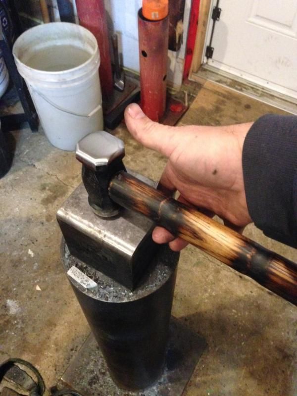

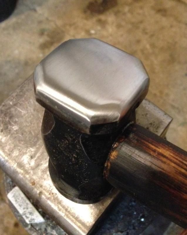

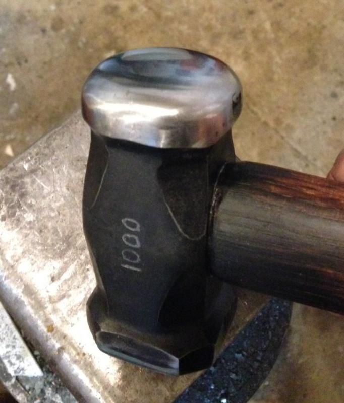

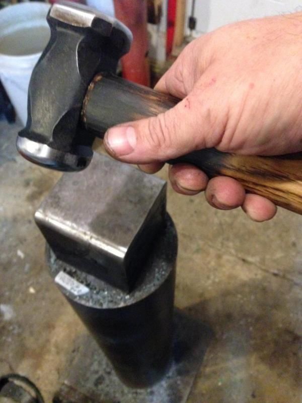

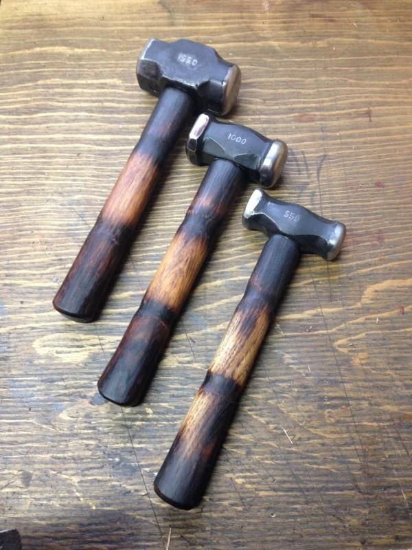

I love hammers ... no, really ... I spend ten minutes standing in the hammer aisle every time I go the hardware store and do a web search at least once a month. I am searching for the ultimate style but know deep down, that it is futile. My latest additions were the rounding hammers. They are made from sledge heads and have been ground, heat treated and re-handled. They have one round/domed face and a square/flat dressing on the other. They are compact, versitile and can be used a different angles to move steel the way you need it.
Here they are in 1550g(3.4lbs), 1000g(2,2lbs) and 550g(1.2lbs) ...
The rounded face moves metal fast and by changing the angle of the head I can get a different radius...

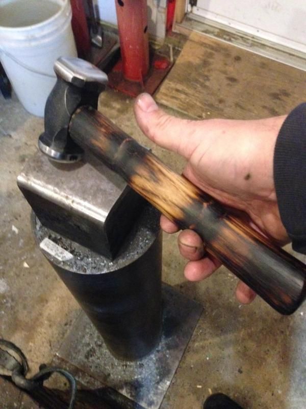

The flat face is great for bevels, finish work and by using the edge, I can peen from any side without missing a stroke...
The hickory handles are grooved at two locations for indexing...
I mostly grip the hammer with my middle finger acting as the fulcrum and my index finger and thumb controlling the angle of the striking face. My palm is mostly facing down while forging... like I am bouncing a tennis ball. The grip is light and I stand very erect(no hunching over). I stand at 45deg to the anvil and the length of the handle is at 45degs to me. That places the handle parallel to the length of the anvil(if my anvil wasn't square:p). It is heavily inspired by the Hofi Technique For Moving Metal(look it up). It is also very similar to the way I was taught to play the drums, so it felt very natural to me from the start.

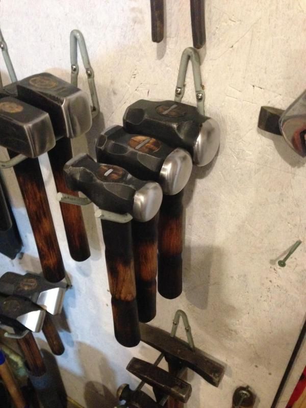

I can pretty much do everything I need with these three hammers. The two French hammers in the background were the ones I learned on and still have a place on my wall. But, these newest beaters have really proven themselves over the last several months. Could this be the end of my quest?... I hope not!

did you make those? and when you say you can do most everything you need with these, do they replace your cross peens somehow?? thanks.
Yes, I am addicted to making my own hammers... though, I cheat and use sledge heads so I don't have to drift by hand. I have spoken to the reps for the two popular brands around here(Garant and Benchmark) and they both use 1060. I rarely use my peens anymore. The rounding face and the edge of my anvil get the job done well.

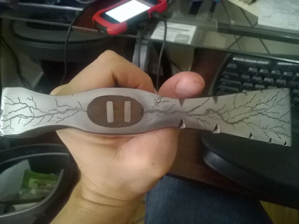

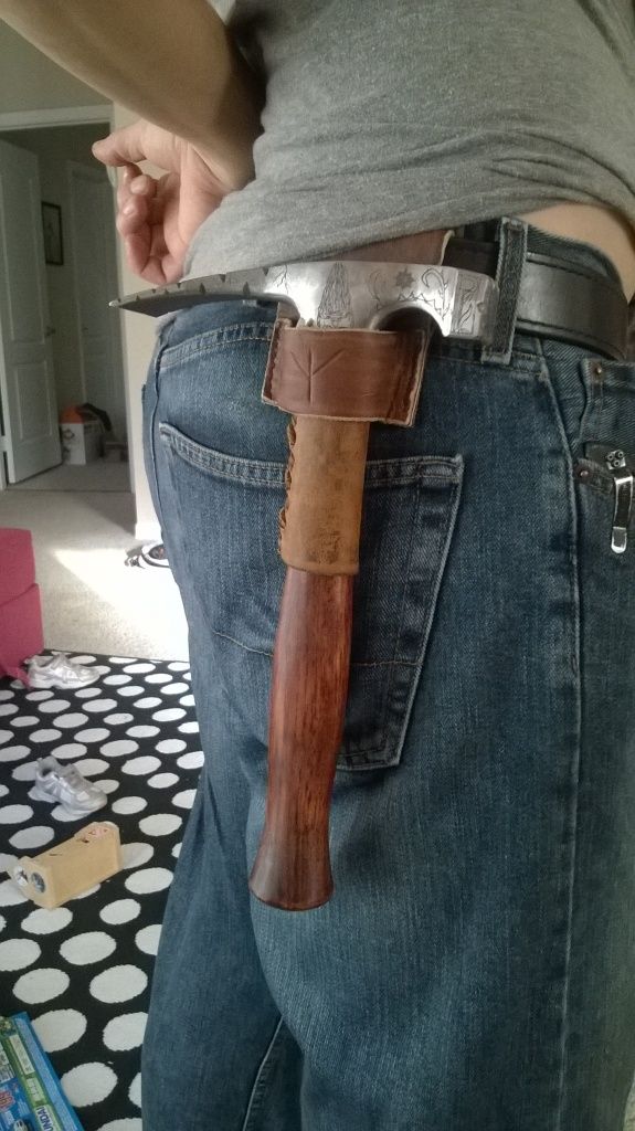

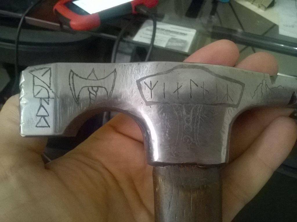

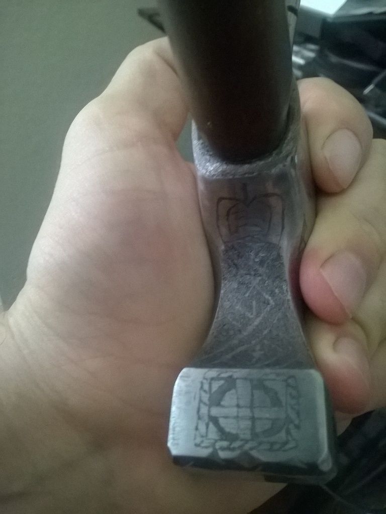

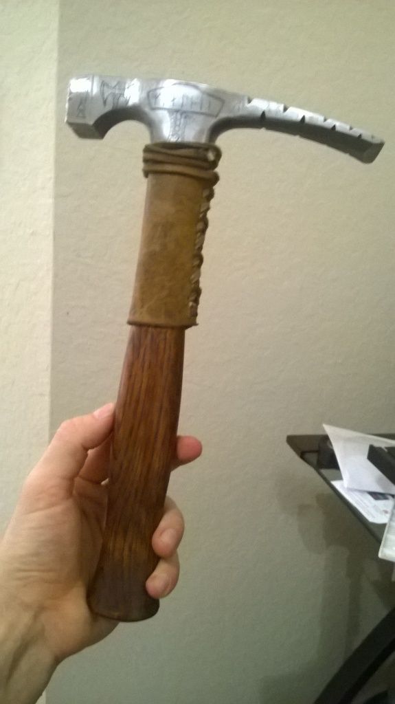

My lil sis is a sculptor. I made her a Mjolnir for Christmas out of an Estwing Bricklayer
