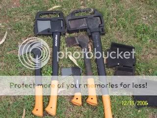

I just made a heavy mallet from a section of stout log. Works like a charm. ;)

You can see the mallet I made at the top of this pic. The top is flat (being the end of the log I used to make it) so it's standing on-end.
