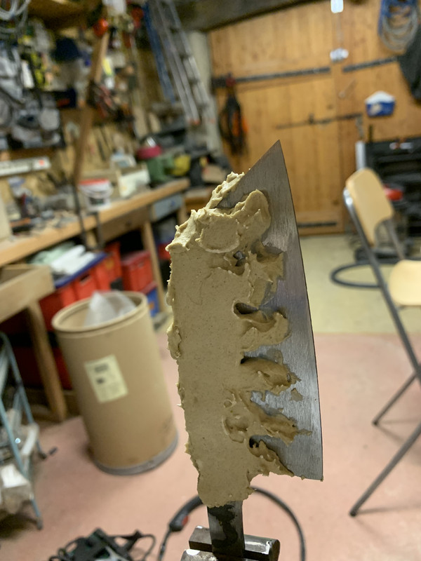

Heyy!
First of all im really new on this forum and also to knife making so sorry if thats not the right place to post and same if i say something thats not true
So i tried to make a hamon on a piece of C130 today, i used refractory ciment for the clay, then quenched in water

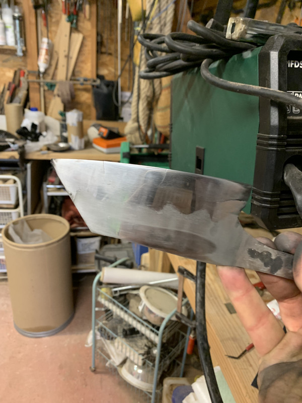

The blade wass too hot so it broke. But i etched it anyway to see what it look like. But on the blade the upper part is white and the lower part is normal steel. On pictures i have seen the upper part is darker. Why? Is that because of the quench too hot?
You should ask a moderator to move this to the knife makers section here on BF. Lots of guys there to help.
That's just a function of the polishing and etching process. Often the harder edge polishes out bright, while the part above the line has a bit more texture, so we leave a bit more oxide up there.

OK, here is what I see as issues you will need to eal with:
1) C130 will take a hamon, but the .2% Cr may make it harder to get a good activity.
2) The clay is way too think. 1/16" to 1/8Max is all you need.
3) Water is not the quenchant for a hamon in C130. 8-10% brine is better than plain water.
4) Avoiding overheating s very critical. Heat to the lower end of the hardening range. For your steel I would suggest 1435°F/780°C.
Once quenched be very cautious with the blade. Temper immediately, at round 400°F/205°C.
After tempering, clean the blade and grind the bevels to 220 grit. At this point you can check the hamon to see how it looks. Etch in 1:5 FC (1 part stock solution FC to 5 parts water). If all is good, finish the blade and re-etch when at 400 grit. There are all sorts of polishing tricks for getting the most contrast on a hamon. Use the Custom Search engine in the stickys to find them.

Hey! First thanks for moving my post.
For the quenching what is brine? Salted water? Why that? It cool faster ?
Then for the etch I did in 1:4ferric but my question is what make it either black or withe (upper part) u can find knives with totally different Hamon color, Is that due to the etching solution?

1:4 ferric/water is too strong for working on a hamon. I use 1:15. Other acids are lemon juice, vinegar, or 1:100 HCl.
Brine is water and salt. To make an 8% solution, dissolve 350 grams salt per 5 liters water. Warm the brine to 40-50°C.
yaki-ire is what a hamon quench is called in Japanese. It is a very fast and violent quench, and you will crack and break blades a lot while learning it. Most folks learn to do a regular quench for a long time before attempting a hamon quench, so with only a month of experience, you can expect a lot of failures in yaki-ire. We often call the sound of a failed quench, "The dreaded PING'". It makes a sound you can hear and feel in the tongs - a sharp PING or TINK.
Heat control in a quench is hard to teach over the internet. If you have an experiences maker to teach you it will help a lot. A forge will overheat a blade really fast. Using a magnet to test when the blade is ready to quench is a good way to know an approximate temperature. When the blade stops sticking to the magnet, stick back in the forge for a few seconds and then quench. Obviously, a HT oven is far better, but most new smiths don't have one yet.
There are lots of reasons the metal will not etch dark. Decarb is the most common. Basically, the higher the carbon, the darker the etch. Structure also affects the degree of darkening. Martensite etches darker than pearlite. In a hamon blade, the edge is martensite, and the upper part is pearlite. The place where they meet and mix is the hamon. The frosty look and little islands of bright spots of the hamon and area around it are from fine and coarse martensite crystals of nioi and nie.
What Hoss was saying about kurouchi blades is the colors are from forge scale which is a form of iron oxide. Kurouchi is entirely different from yaki-ire.
Etching the blade with FC and then carefully polishing the blade with various oxide powders is how those fantastic hamon blades are finished. What most folks do is called a hybrid polish.
