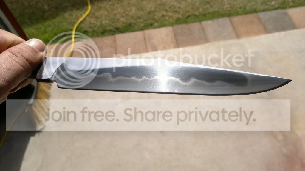

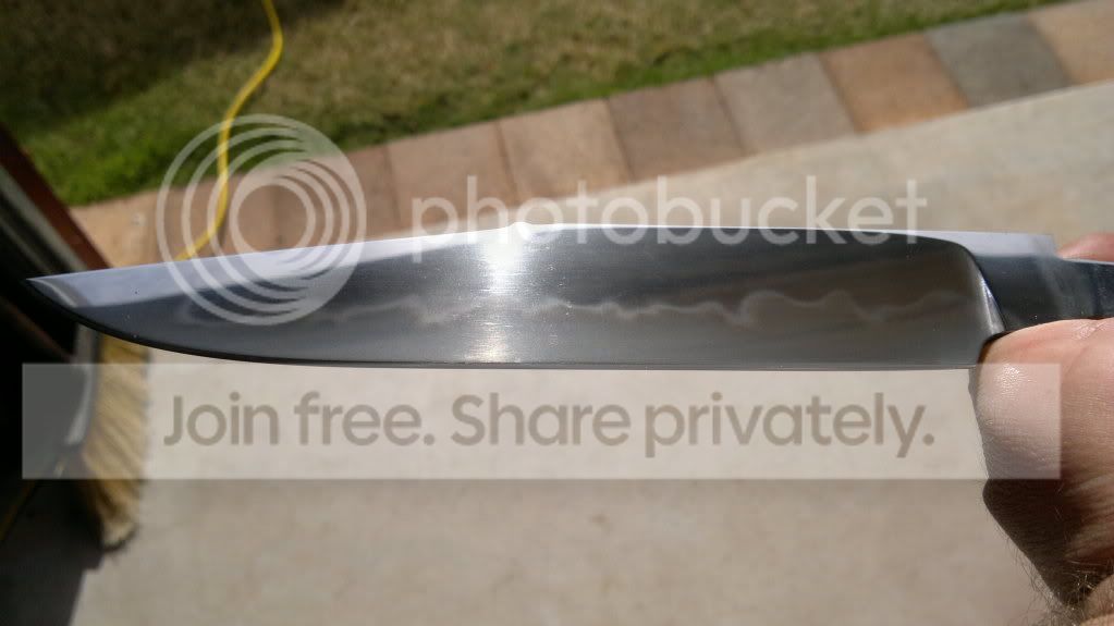

this is my first try at pollishing up a hamon on one on Nick Wheelers blade he sold off
how do you thinks this is going this is the 8th etch should i stop or keep going
its still not as good as Nicks look and has some scratches that i can now see but am i on the right track
sorry these are the best pics i could get

thanks guys but after watching nicks hand sanding vids im going to resand it, there are some small scratches and J hooks that i can see and i hand sanded to 2000g then buffed with green crome then white so it should be a mirror
nick that edge you can see in the pics is the bevelled edge dont ask me why i did it i had a 400g belt on the grinder and it just happened, but its not sharp
I'd now go onto finger stones, if it was me doing it. Just use the Hazuya below and Jizuya stones above/on to crisp up the the "clouds"
IMHO, you don't want to buff the blade if you're going to etch it like this... buffing "smears" the surface of the steel and it won't show things as well as a hand sanded blade. :)
ok so buffing is out, ill sand to 2000
