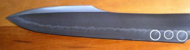

I got the picture below from Fogg's forum. I circled a couple things of his hamon (these "wisps" in the hamon are ashi, no?). My question is how do you get these? This is the activity that is missing from my hamon. What I want to know is this: do these "wisps" form under the clay "stripes" that Engath describes as being the first step in his clay coating procedure? He describes using a palette knife or something along those lines, getting a bit of Satanite on it, and smacking the side of the blade to transfer it like a line of goop to the side of the blade. After doing that at regular intervals, then he puts a thicker coating toward the middle/spine of the blade of clay.
So, do these wisps come from that, or what? This is the only thing, other than forging, that I do not do on my blades, and I don't see these wisps in my hamon, so is that why?

Those are tough -- especially if you'd like a controlled "line" and the ashi. I just pulled some good long "ghost" ashi on a blade that I had no clay on it. I'd have to check my notes, but I think it was a 3/4 quench in AAA (slower oil) that caused the legs. The heat from the spine basically creates the activity as it cools slower (Matt Williams is a good person to talk to about that one). Not sure how Don gets his because he does full quenches.
I've been taking a lot of notes and recently have done a batch of seven simple blades with a variety of clay coats, quenchants, and quench depths. I'll let you know how they turn out when I get around to grinding on them.
Hmmmmmmm. So, you're saying you've seen them doing edge quenches? I dunk my clay coated blades all the way in. I never thought about clay coating AND edge quenching at the same time. Damn. Thanks!
heck -- don't even need clay. ;) I'll get a pic tonight and post it. Of course, that is just one option -- there are many different ways to do it. If I had an inkling I would think that Fogg possibly uses different thicknesses of clay-coating to get some of the activity, but not sure.
Mayhaps Nick will chime in -- like he and Fogg have both said, the clay doesn't make the line, you make it with your heat-treat and the clay just helps guide it.
Ultimately, yes. They have a major influence in the character of the line.

So, is 1095 and automatic transmission fluid a bad choice to try to do this with?
1095 and ATF is good for hamons. The smoky fingers I get are usually under the clay, but sometimes there is no rhyme or reason to getting these. Hamons will drive a normal knife maker insane :) they are addictive and will keep you awake at night :) The close up is 1060 clay coated and fully quenched in oil. The other bowie is W2 clay coated and edge quenched in oil, alot of activity in this one. Hamons are very difficult to photograph.

Time and Temp is most important in producing a lot of activity in the hamon.
Too much heat and no wisps or ashi.

Here's one I just shot to show that you don't have to use clay to get ashi. This is just taken to 320 and etched in FC. I can't wait to finish this one up. :)
