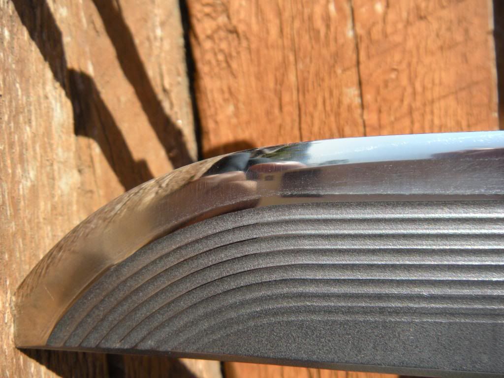

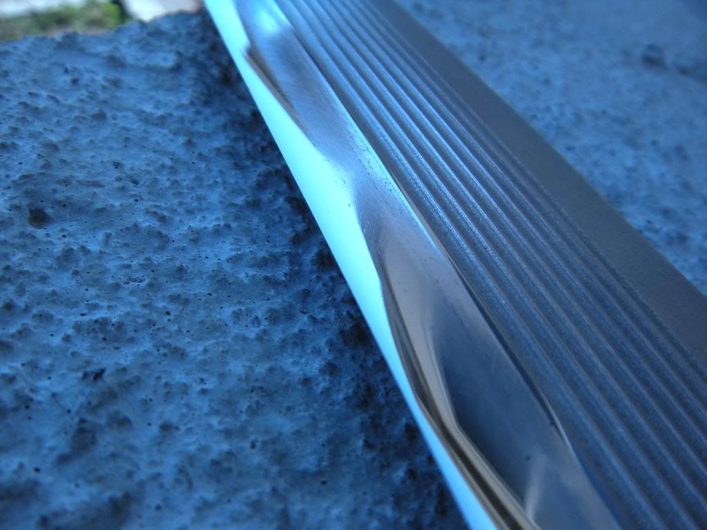

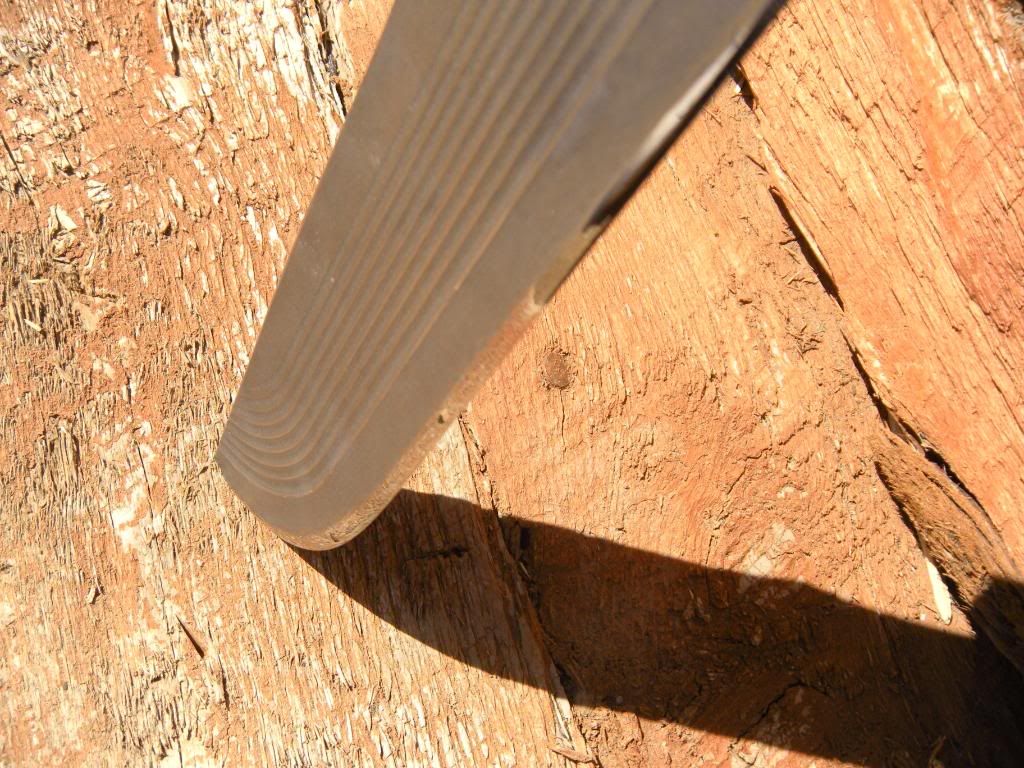

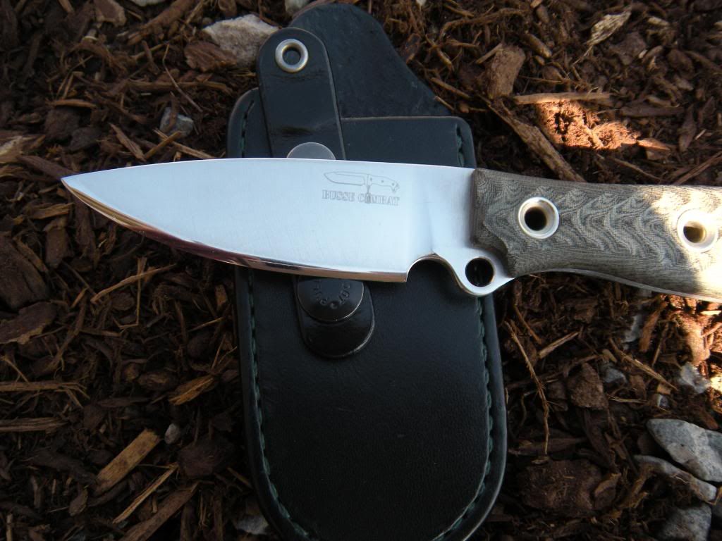

The carat weight is what is in the bottle. The concentration is higher in smaller bottles. In my experience, HA products are second to none. I have been using them since they were offered on japaneseknifesharpening.com. My favorite setup is the CrO at .5 micron on a strop, followed by another strop loaded with .25 micron diamond spray. UNBELIEVABLE edges....
I personally think that the higher the polish, the more durable the edge. In my experience (and has been mentioned here many many times), thin angle is the weakness of most steels, not high polish. I have to take some good shots of my Sebenza, S30V is amazing when its polished.
I'd order from them soon, as they tend to make products in batches (at least the diamond sprays). I had to wait about 3 months after I had used a bottle, for them to offer more for sale.....
Nice looking edges rangerover, you don't find 0.25 to be too fine? I like it for some carbon steels, and some S30V responds well to it but for the most part it just seems to smooth out the edge too much. I don't have the HA 0.25 though so that might be the difference.
I really like the HA products, nothing has even compared!!! I really do notice a jump in sharpness from .5 to .25. Maybe its me.....
