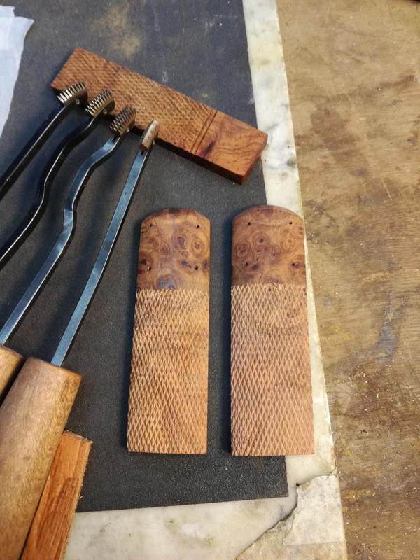

I've checkered this handle.
It is a slow process but I find it enjoyable
(it's a three finger knife for myself in olive wood)

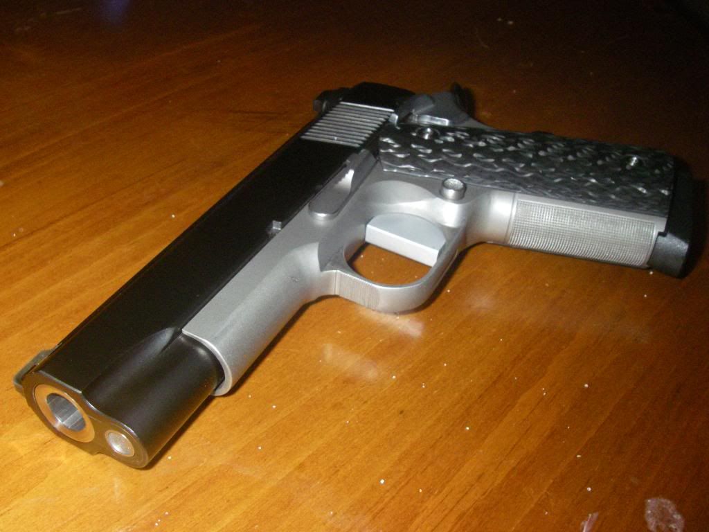

Absolutely, but not with the checkering tools used on wood. I checkered the front strap of a Titanium framed 1911 years ago with Gobbets checking files at 40 LPI. It was not fun.
By the way, Midway company, who made this video, sells all the tools that you see in the video as well.
Checkering the front and back straps of a pistol can also be done with something like 20 LPI, and better if you make 'flat top checkering ' instead of bringing them to points. This saves on clothing wear for concealed carry while maintaining excellent grip !
